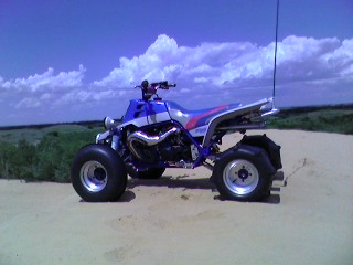

Hello All. Thanks for looking. I got this banshee last week from a guy that took really good care of it. I traded a salvage title CBR1000 for it that he plans on putting the motor into his other banshee frame.
ANYWAYS - I need advise on what fluid to put back into the bike. He said he has some syntetic 10w40 in there now. Personally, riding harleys for years I think it needs something a little thicker, but I don't know. What do you suggest.
My concerns are that I was out in the dunes buy the river and ran close to empty on fuel. I still had some left but not enough to get me back. I used another guy pre mix that he had and now im finding out that - that is a no no. The bike has always used Castor 927 and VP 110. This guy had 91 and Lucas Semi-Synthetic 2 stroke oil in his. His was mixed at 40:1 and mine has always had 36:1. Will the 2 different oils in there cause me trouble? Should I drain it all or should I start running the Lucas since its already in there now? HELP!
Next is that in nuetral it idles pretty decent. Once in first and warmed up if i pull up next to someone and hold my clutch in the bike bogs down and dies pretty fast within 30 seconds or so even if i try to throttle it up it acts as if its being choked out. Any help on this from someone. Its like its still under load or something. as long as im moving it runs like a striped a$$ ape though.
The motor I was told is bored and polished. I dont know how big because I havent had it apart and he said he didnt remember but that it hasnt been sleeved or anything. It was the second bore and overhaul. He has had sometiime playing with it and its running good now. Should I go ahead and re-ring it and get it honed or wait till it stops running good on me? How do I know when its time to do an overhaul on the top end?
Next I heard that you are supposes to replace your reeds every season? True? This bike has brand new V-Force 3 on it and damn that will be expensive to replace every year. Anyways thanks in advance to all the experts out there. If it works I will enclose a picture of the bike. Also, rings and cylinder honing every year or 10 hours? true?
