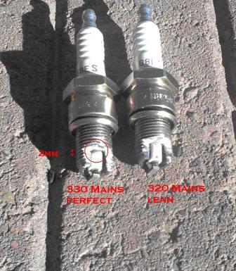

Strawboss Posted June 6, 2008 Author Report Share Posted June 6, 2008 Here is my revised Plug Chop How-To using the HQ FAQ procedure and some other information that I gathered. I think it might help some of the people who are trying plug chops for the first time. I am not sure how to get the plug picture to show up in this thread but I included it as an attachment. Later, Ryan 2-Stroke Plug Chop How-To: ________________________________________ 1. Get new spark plug(s), but don't put them in yet. 2. Warm up motor to operating temp on old plugs. 3. Install new plugs. 4. Accelerate through all gears to top gear with throttle pinned (try to use a high gear if not top gear Quote Link to comment Share on other sites More sharing options...
