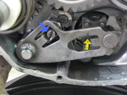

P-man Posted March 30, 2008 Report Share Posted March 30, 2008 (edited) Ok, i took took the clutch side cover off of my banshee and am trying to identify a shifting problem. The shifter doesn't always grab.. when i turn the marked screw the shifting assembly moves up and down so i am pretty sure it is bent. also the marked spring is not very tight at all and has a little slack, do these look like the problem? Thanks Edited March 30, 2008 by P-man Quote Link to comment Share on other sites More sharing options...

FASTOYS Posted March 30, 2008 Report Share Posted March 30, 2008 Pman, your slotted stud is an eccentric stud and is supposed to move up and down in a cam/eccentric like fashion. From the looks of it i think your shift shaft spring may be worn. Give me a call on the phone tomorrow and i will walk you through what to look for. 785-364-5325 10-2 central time. Quote Link to comment Share on other sites More sharing options...
C&B Posted March 30, 2008 Report Share Posted March 30, 2008 Pman, your slotted stud is an eccentric stud and is supposed to move up and down in a cam/eccentric like fashion. From the looks of it i think your shift shaft spring may be worn. Give me a call on the phone tomorrow and i will walk you through what to look for. 785-364-5325 10-2 central time. FASTOYS is right, easy fix, let him walk u thruogh it though, Quote Link to comment Share on other sites More sharing options...
P-man Posted April 1, 2008 Author Report Share Posted April 1, 2008 FASTOYS is right, easy fix, let him walk u thruogh it though, I tried to call today Fast toys, ill try again tomorrow if that is ok. Is it possible to buy a replacement spring to go on the end of the shift shaft or do you have to buy a new shaft part from an oem place Quote Link to comment Share on other sites More sharing options...
