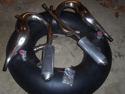

here ya'll go. 2 cut powercore II's the stingers are cut off because they were jimmy welded in the first place. im gonna rebend and weld some new ones once the bikes more togeather.gonna PC the end caps too.
measure the part you removed to determine how much core to remove
finished silencers, unpacked unpolished. raw shortened shittyness. itll be better when i get around to it
i removed a total of 4.5 inches per silencer
