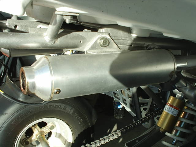

dekker Posted February 2, 2008 Report Share Posted February 2, 2008 Alright guys- So I went to mount up my CPI's yesterday and the expansion chambers mount up just fine but the stinger tubes dont wannt go in right at all. My question is do you run a hanger on the back as well or can you manipulate them enough to get them to bolt in up by where the grab bar bolts on. Any help would be appreciated. Thanks Zach :beer: Quote Link to comment Share on other sites More sharing options...
Frogger Posted February 2, 2008 Report Share Posted February 2, 2008 They should just bolt up. Just play with them a little and they'll go. Quote Link to comment Share on other sites More sharing options...
FireHead Posted February 2, 2008 Report Share Posted February 2, 2008 They should just bolt up. Just play with them a little and they'll go. Word, mine fit fine. Are you sure you have the stingers on their correct sides? Quote Link to comment Share on other sites More sharing options...
dekker Posted February 2, 2008 Author Report Share Posted February 2, 2008 Yea Im sure they are no the right sides maybe I just gotta mess with them some more but they keep wanting to hit the frame. Quote Link to comment Share on other sites More sharing options...
jbooker82 Posted February 2, 2008 Report Share Posted February 2, 2008 My sub frame has a a little twist so I used my hangers off of my toomey pipes. Quote Link to comment Share on other sites More sharing options...
dekker Posted February 2, 2008 Author Report Share Posted February 2, 2008 Thanks for the pics ill fiddle with it some tonight and maybe snap some pictures if I cant get it. Thanks Quote Link to comment Share on other sites More sharing options...
C&B Posted February 2, 2008 Report Share Posted February 2, 2008 Thanks for the pics ill fiddle with it some tonight and maybe snap some pictures if I cant get it. Thanks I love my CPIs, hate the fucking fit. They suck. Mine r so bad, they broke my hangers. Just do the best you can. Quote Link to comment Share on other sites More sharing options...
BigRed350x Posted February 3, 2008 Report Share Posted February 3, 2008 I did a test fit a while back and if you can get just the silencers and want a cleaner setup, shearer silencers and stinger tubes fit with CPI's with a little tinkering and cleans things up a lot more. Quote Link to comment Share on other sites More sharing options...
dekker Posted February 3, 2008 Author Report Share Posted February 3, 2008 Alright well did some looking today and realized that when I got the stuff the silencers were apart from the tubes and I thought I was putting them on the correct side because the muffler can only bolt up on one side but turns out when I put the silencers on the tubes I switched em lol oh well shit happens! I heard about cpi's having shitty fitment but damn lol. Its all good now. Thanks for your help! Zach :wallbash: :wallbash: Quote Link to comment Share on other sites More sharing options...
