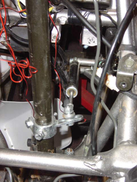

Bobman13 Posted January 21, 2008 Report Posted January 21, 2008 Here is a Pic how the PEP one is mounted. I Bolt Directly to the Lwr. Motor Mount. Quote

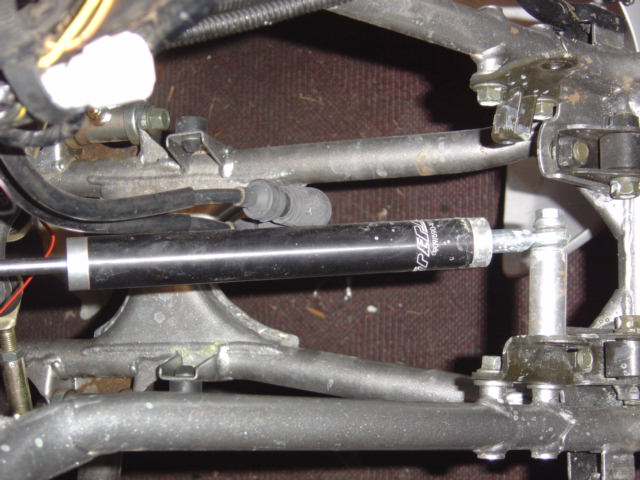

Bobman13 Posted January 21, 2008 Report Posted January 21, 2008 Here Is where it attaches To the Stering Stem you Have to make Sure you Mount it low enough on the Stem As to not interfere with the Radiator and that the stem turns freely in both directions, I also added a 1/8" washer to the lower rad. mounts just for Grins. Quote

kawa110 Posted April 7, 2021 Report Posted April 7, 2021 Thread mining.... I attempted to bolt the pep stick stabilizer up like pictures above... oversize radiator, Paul turner pipes. I used the same motor mount bolt hole as pictured. I had to run my stabilizer and the stem clamp to the opposite side of the photo above as the lower water neck and rad hose was in the way. Seems I won’t notice the dampner “working” until I hit something hard going fast. Quote
