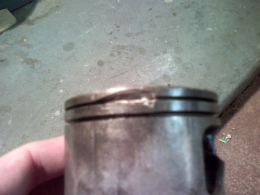

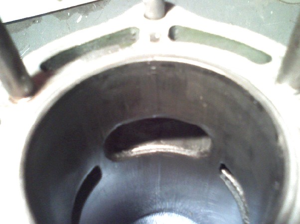

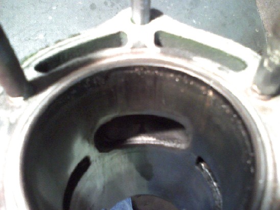

last trip out to Dumont Dunes my motor went bye bye, anyway, it looks like the top ring in both cylinders managed to get stuck into the exhaust port a little bit and snag busting up the pistons. My question is, the exhaust ports got a little bit messed up, would it be safe to just bore the cylinders and put new pistons/rings/wrist pin bearings. or should i get port work done, I'll try to post pictures that look halfway descent, but all i have for a camera is my cellphone, so quality may lack a bit.
Right piston ring groove damage, left is about the same

WEll yeah, the pics don't help but you way want to look at having a porting guy check the ports for proper chamfer or even just port the cylinders to fix your problems. I with many of our customers, we port the bad spots away when working the exhaust port. I strongly recommend a pro look at your issue to see why it hung a ring in both cylinders. a super loose motor can do it but you need to know what happened.

well, i know the motor was gettin really really loose, unfortunately i didnt take the time to look into how bad it was, far as i can tell its 100% stock topend except for the coolhead, and its a 97, so 10 years on a topend, it may have been re-ringed but it hasnt been bored. I Wish any of the machine shops that do 2-stroke stuff here in Vegas would actually return phone calls or pick up the phone when i call. I'm really strapped for cash at the moment so im not lookin to get this done right away. I did find one shop in town (quad mania) that will send my cylinders out to be bored/ported (75/cyl for bore and 350/cyl porting). Does that sound like a good deal, or should i send out to one of the highly recommended guys outside Vegas.?
