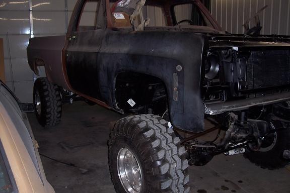

peak-j Posted October 29, 2007 Report Posted October 29, 2007 Here's a few pics of my truck that I've been working on for about 6 years off and on now. Quote
ClimbAnyHill Posted October 29, 2007 Report Posted October 29, 2007 Nice, what's under the hood & undercarriage? Quote
peak-j Posted October 29, 2007 Author Report Posted October 29, 2007 350 .60 over, 2.02/1.60 valves in world products aftermarket heads, edelbrock performer intake, edelbrock carb. flat top pistons. The lift kit is an 8 inch superlift kit, with 1-1/2 front shackle lift. I also changed the steering over to crossover steering, which means now it steers from the passenger side wheel. 38x15.50x16.5 super swamper radials. SM 465 4 speed with a centerforce dual friction clutch. My dad and I installed a dump bed on it also. Since the picture I have also put on a 9000 lb. superwinch. That's about it for now. Quote

peak-j Posted February 22, 2008 Author Report Posted February 22, 2008 I went to the salvage yard and found the pass. side knuckle that has the flat top on the older style D44, had it machined and drilled for studs. I can't remember where I ordered the parts for it, but I could find out if you need to know. The spacer, studs,wedges, and knuckle arm were the parts that were machined so I ordered them. The pitman arm is off of a jeep, and I used the steering box off a two wheel drive 78 chevy. Couple more pics. http://img227.imageshack.us/img227/2830/11531hm7.jpg http://img217.imageshack.us/img217/1543/51011ww2.jpg Quote
