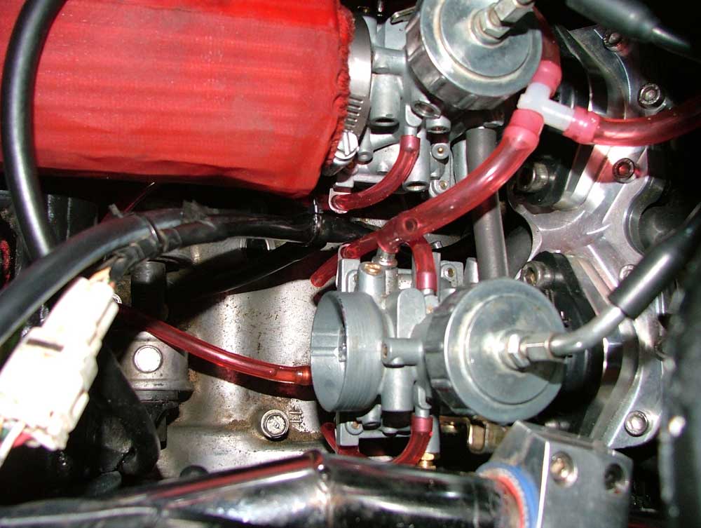

jbooker82 Posted October 14, 2007 Report Share Posted October 14, 2007 Are you talking one piece as on maniflold for both cylinders or it is made out of 1 solid pice of aluminum. I think all the internal crossovers are made out of two pieces. Here is a pic of my boss. Quote Link to comment Share on other sites More sharing options...
