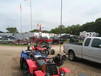

peak-j Posted October 7, 2007 Report Share Posted October 7, 2007 (edited) Hopefully you can see it in the pic, first bike shown. If you can't see I'll try to get one tomorrow. Edited October 7, 2007 by peak-j Quote Link to comment Share on other sites More sharing options...
