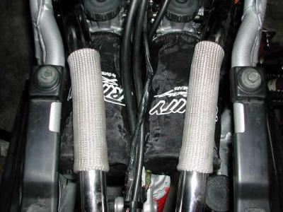

if you go to cascade-innovations.net they sell some slip on covers for stingers that will prevent future problems with outerwears. or, on my first 4mm, I used a huge zip tie to hold the pods close together, which gave clearance along the stingers. Either way worked great for me, and no more holes in the outerwears.

Or getcha some header wrap which is what I did.
Stopped the problem with burnin holes in the TOPS of the air filters.
Now getting the bottoms of the filters to stop rubbin on the frame and upper, rear shock mount
is another story.

I'm running the K&N Angled pods. I have CPi BB and have not burned my outerwears yet. I do put a few rubber bands around the outerwears to keep them away from the pipes frame etc. I have PWK33's but that should not matter. On some bikes or with some pipes (same kind or not) burning the outerwears will be more of a problem. I have some header wrap but decided it not to use it. Waste of $25 or whatever.

These spark plug boot protectors will keep your pipes from burning the outerwares and can be bought at advanced auto parts http://designengineering.com/products.asp?m=sp&pid=22 .The cheapest place I have found for outerwears is http://www.tsracing.com/store/showprod.cfm...ectGroup_ID=121

Because my outerwears did not touch the pipes like I thought they would. It either has to do with the new frame or swithcing to Big Bore CPI's or both. The angled pods is key!
Man, I like those very much. I always have to run a piece of safety wire around my 2:1 filter so the outerware won't burn on the left (I think it is the left) stinger. Those protectors will solve that problem. And silver or black will be just right.
