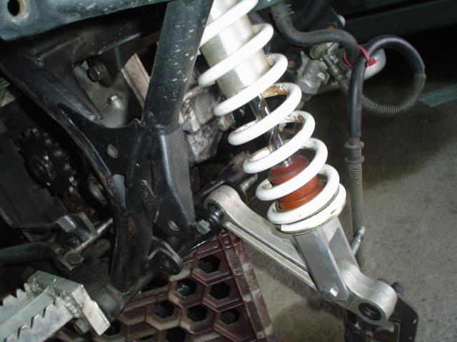

djackbanshee Posted July 22, 2007 Report Share Posted July 22, 2007 Since my front end is longtravel and the back suspension just can't follow the front. I am starting this new project. Fitting a rear yfz shock on the banshee. the easier way and best setup i found is using a 400ex linkage. i will also be building a custom swingarm to fit the linkage. top shock mount has to be modified to fit the shock and original mount has to be cut so the shock can have more angle because now it's kinda too horizontal. heres the pics of what it should look like. Quote Link to comment Share on other sites More sharing options...
ClimbAnyHill Posted July 22, 2007 Report Share Posted July 22, 2007 How much longer is the YFZ rear shock from the Banshee rear? Quote Link to comment Share on other sites More sharing options...
djackbanshee Posted July 22, 2007 Author Report Share Posted July 22, 2007 4 or 5 inches Quote Link to comment Share on other sites More sharing options...

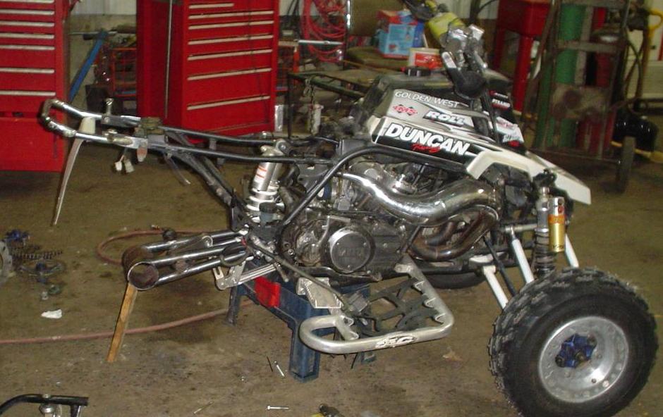

djackbanshee Posted July 26, 2007 Author Report Share Posted July 26, 2007 with the new swingarm i am fabricating Quote Link to comment Share on other sites More sharing options...
zach45 Posted July 26, 2007 Report Share Posted July 26, 2007 and the ass wont sit all the way up on the bike? or the linkage wont be to low where it will hit shit? Quote Link to comment Share on other sites More sharing options...
djackbanshee Posted July 26, 2007 Author Report Share Posted July 26, 2007 no the linkage will not hit it's pretty well in the same place as the stock one Quote Link to comment Share on other sites More sharing options...

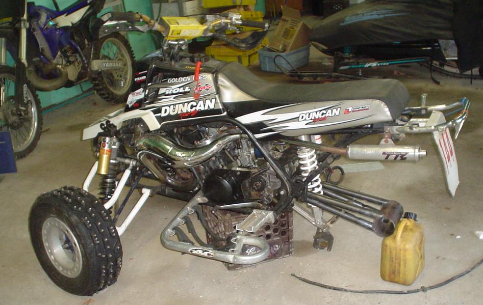

djackbanshee Posted July 31, 2007 Author Report Share Posted July 31, 2007 ok it will be done soon everything looks perfect i think it will fonction very well Quote Link to comment Share on other sites More sharing options...
RZBansheeMan Posted July 31, 2007 Report Share Posted July 31, 2007 Lookin damn good ! Maybe you could make it into a kit and sell to compliment "2003limitedbanshee's" YFZ 450 front end kit......... Quote Link to comment Share on other sites More sharing options...
djackbanshee Posted July 31, 2007 Author Report Share Posted July 31, 2007 yes i did think of making kits but some welding is required for a new shock mount . but it would be possible Quote Link to comment Share on other sites More sharing options...
racer Posted August 1, 2007 Report Share Posted August 1, 2007 Think you can snap a good shot of those welds? I'm not afraid to cut shit apart, and this looks like fun! TIA Quote Link to comment Share on other sites More sharing options...
DieselTech Posted August 1, 2007 Report Share Posted August 1, 2007 A few questions: 1) Are you keeping the stock swinger length? 2) weight, compared to stock (lighter?) 3) intended purpose (MX, GNCC, etc.)? Looks pretty good though. Why not just use the new Elka linkage & shock though? Cost a factor? Or just something you wanted to try to build? I'll be keeping my eye on this fab job as well. I think it's cool when people build their own stuff - that's what you call "one of a kind" !!! Quote Link to comment Share on other sites More sharing options...
