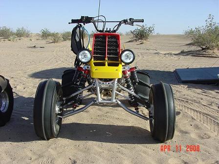

FelixTheCat Posted August 28, 2008 Report Share Posted August 28, 2008 you should get Kevin Herr to post a pic of his partners shee with the long travel shocks for guys who want a taller stance on their rides . He says it's a great dunner... Here you go... Quote Link to comment Share on other sites More sharing options...
THE GRIM RIPPER Posted August 28, 2008 Report Share Posted August 28, 2008 There yfz Arms???? What did he move the shock mounts? Quote Link to comment Share on other sites More sharing options...
mofoka Posted August 29, 2008 Report Share Posted August 29, 2008 Here you go... Nice bike, that looks like a lot more clearance then the other yzf450 set up's .... is that from the elka's or how did you do that with those arms? Quote Link to comment Share on other sites More sharing options...
FelixTheCat Posted August 29, 2008 Report Share Posted August 29, 2008 Nice bike, that looks like a lot more clearance then the other yzf450 set up's .... is that from the elka's or how did you do that with those arms? Its mostly from the elkas...17.5" eye to eye...and the tires I run are taller then most tires with the same numerical size... but they are stock upper and lower yfz arms mounted in the stock banshee locations...I'm also using the yfz spindle/hub/brake assemblies... it has a bit of neg. camber which gives it better steering through the dunes... Quote Link to comment Share on other sites More sharing options...
THE GRIM RIPPER Posted August 29, 2008 Report Share Posted August 29, 2008 Wow... Thats an ultra sweet setup.... Way lighter Im sure to. Damn, I wouldnt mind gettin my hands on a YFZ front end after seeing it with some Lt Elkas! :ermm: Quote Link to comment Share on other sites More sharing options...

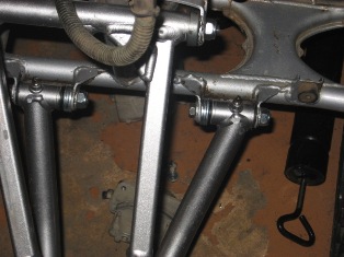

The Quadfather Posted October 13, 2008 Report Share Posted October 13, 2008 Ace Hardware carries a 14mm washer that is a perfect fit on the sleeve. Three fit perfect as a spacer for ones on a budget. Is that all you need to make those a arms fit right.............i read about having to grind the top bracket for the shocks,but havent figured out what i need to do to mount the arms to the frame.......................One of my bros is thinkin about sellin me his stock yfz shocks and arms off his SE.........Yellow shocks black arms,a perfect match to my SHEE Quote Link to comment Share on other sites More sharing options...
boneyardbanshee. Posted October 13, 2008 Report Share Posted October 13, 2008 you need to cut the outsides of the lower arms. the spacer goes on the other side. the top arm goes right in. if you look at his pic you can see where it needs cut (right next to the weld). :thumbsup: Quote Link to comment Share on other sites More sharing options...
