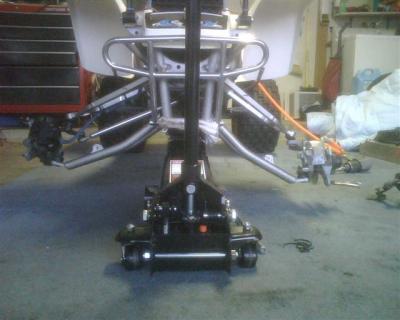

IrideA250R Posted September 15, 2008 Report Share Posted September 15, 2008 I've ridden the crap out of my Banshee this summer, it has a complete YFZ front end (with YFZ Elka shocks) and it's been great. I used the spacers and tie rods from the OP. Quote Link to comment Share on other sites More sharing options...

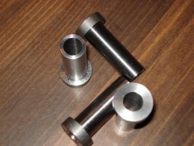

xXBlessedWithDeathXx Posted October 5, 2008 Report Share Posted October 5, 2008 03 limited , ya out there yet ? Still need those bushings ! if it helps you can go to a hardware store and get washers that will work for spacers. specs are .610" ID x 1"OD. if you can find a thick washer to fit it should be aprox .275" wide. or you can take them dimensions and get some made. i found them specs on a old post. Quote Link to comment Share on other sites More sharing options...

2001Stroker Posted November 16, 2008 Report Share Posted November 16, 2008 So if someone gets killed on this redneck set up you have stupid insurance? Why is it redneck? Not only does it add 5" of front width and puts your spindles 5/8" forward, but the geometry is way much better than the banshee's. So what, you have to use bushings. Aftermarket arms that use heim joints use spacers. Ain't nothing redneck about it. Quote Link to comment Share on other sites More sharing options...
