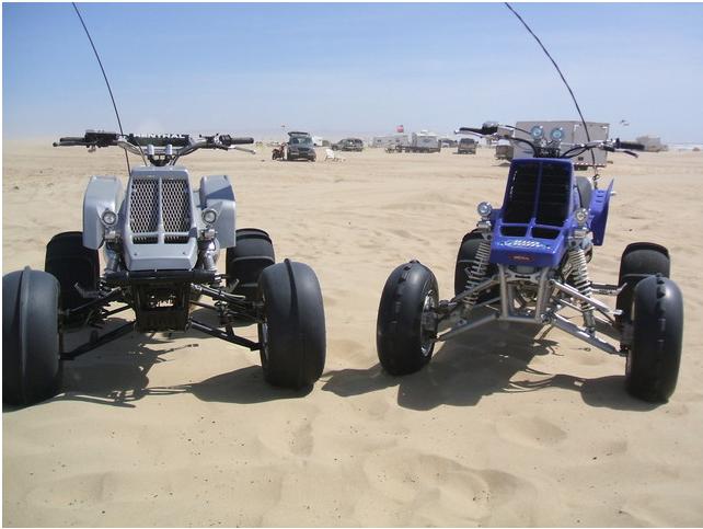

SoCalinIt Posted May 9, 2007 Report Share Posted May 9, 2007 What about the STU Razorbacks? That's what I'm running on my ride, as well as my Z400... I have the 3-3 off-set on mine. These tires are second to none in the dunes. I've ran the Sand Stars, and the Mohawks, and I'll never go back to either! Memo, next time you're out with us, check out the way they float. The STU tires are hella light, and have the most area of rubber to help keep the quad on top of the sand. The single ridge is a lot taller than most. Here is a picture of the STU's vs. Mohawks... Just my .02 Quote Link to comment Share on other sites More sharing options...

jayzx10r Posted May 18, 2007 Report Share Posted May 18, 2007 (edited) What about the STU Razorbacks? That's what I'm running on my ride, as well as my Z400... I have the 3-3 off-set on mine. These tires are second to none in the dunes. I've ran the Sand Stars, and the Mohawks, and I'll never go back to either! Memo, next time you're out with us, check out the way they float. The STU tires are hella light, and have the most area of rubber to help keep the quad on top of the sand. The single ridge is a lot taller than most. Here is a picture of the STU's vs. Mohawks... Just my .02 I have those same fronts on my 'shee and would buy them again. My vote would go to the STU Razor. :thumbsup: Here is what the company says about this particular tire on it's website: www.sandtiresunlimited.com/sandtire1.html Application SAND TIRES UNLIMITED focused on a pretty much ignored idea, Front Tires. Front tires for sand vehicles were just an after thought. Sand is to ATV's as air is to a plane and water to a boat. It all works the same. So, create a bigger tire and more footprint and you get more floatation. Sand moves away when you push off it and it moves around when you apply pressure to it. So, it follows that a front sand tire should turn through an unstable medium, like sand, just as rudders do on planes and boats. We gave this tire a biased rudder. The click the picture to see a profile of the tire. This biased rudder sand tire can be run forward or backward for more or less positive steering control. Recommended for 7" wide wheels and ONLY for ATV 4 wheelers. Benefits * Durable & Rugged 4 ply construction * 22" height when mounted on a 7" wide wheel at 5 psi * Reversible for more or less positive steering control * 10" bead diameter * Mounts on 7" wide wheel * Tire weight - 6 lbs. Edited May 18, 2007 by jayzx750 Quote Link to comment Share on other sites More sharing options...

RoostRocket Posted May 18, 2007 Report Share Posted May 18, 2007 i personally prefer the ss fronts over the mohawks but i never used the buffed bead to bead ones only the shiny ones.from what i can remember i didnt like the ride to and from camp it was hard to steer and really bumpy on the mohawks on the sand they were ok but i still like the STU razorbacks or sand stars better. just my .02 Quote Link to comment Share on other sites More sharing options...
