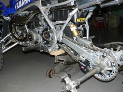

LiftdT4R Posted April 17, 2007 Report Share Posted April 17, 2007 Plastic by far. If the chain comes loose it can potentialy rip that billet one out along with the bolts. The plastic one will have more of a tendency to just break away and not become a piece of shrapnel or a projectile. Where is firehead and his infinite engineering knowledge, when you need him. Either way, I will take a shot at it with my more limited engineering knowledge. I think that TM designs one would be the best bet. It is supported a lot more then the other style ones. the normal ones are supported pretty far down from where the actual force from impact would occur, youd have a torque that would produce a god amount of stress in the bolts. The TM design ones are supported closer to the point of impact. As far as the cheaper ones. You would definately want to maximize the toughness(resistance to fracture when stressed). I would ass-u-me that the billet aluminum one would be tougher, but I don't have numbers on that to back it up, and even so I would think that both are probably very close anyway. I have the modquad billet alumnum ones on both my bikes, if one ever happens to break or get lost, Id probably buy the TM ones. Quote Link to comment Share on other sites More sharing options...

jayzx10r Posted April 17, 2007 Author Report Share Posted April 17, 2007 I'd say the TM Designworks has a superior setup over the rest Quote Link to comment Share on other sites More sharing options...
JET 99 Posted April 17, 2007 Report Share Posted April 17, 2007 yeah what he said....^^^^^^^^^^^^^^^ i got one in mine and its because of how it spreads the load and basically allows chain to feed through without wadding up.... Quote Link to comment Share on other sites More sharing options...

Dgrey Posted November 9, 2007 Report Share Posted November 9, 2007 There is a plastic piece on the stock stator cover that projects into the area that the case saver (when installed) is in. What do you guys do about this? Grind it off? Please advise! Quote Link to comment Share on other sites More sharing options...
jbooker82 Posted November 9, 2007 Report Share Posted November 9, 2007 Just cut it off. Quote Link to comment Share on other sites More sharing options...
