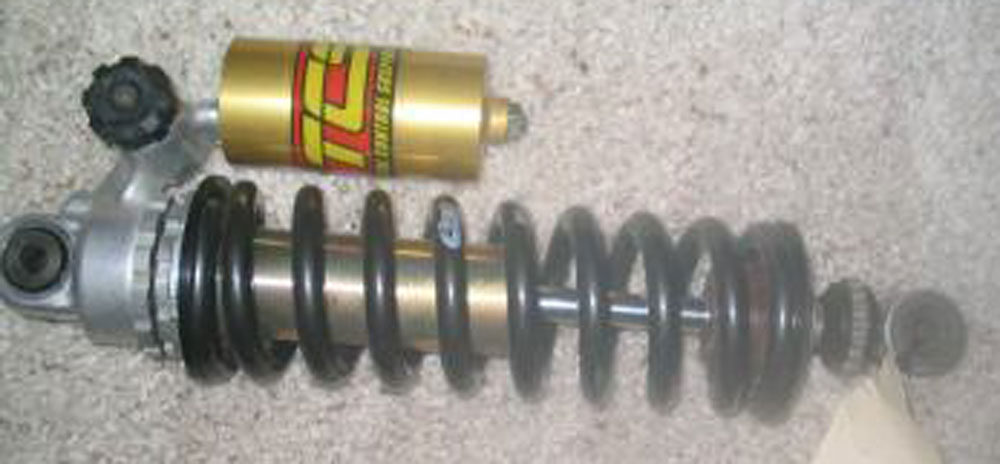

I called TCS today to talk about a eibach spring for my +4 swingarm. Well they tell me that not only do I need the spring, but I also need a spacer. This spacer helps hold the spring in place and that if not used it will slip off. I was told that different models may require more than one spacer to hold the spring in place. Then I called cascade and talked to them about the eibach spring they sell. They said " we have never heard of this " and we use these springs all the time on banshees. So I guess I am really confused as to do I or don't I need the spacer for the rear shock. And two who has used the eibach spring from cascade and did you have to use a spacer? i just want to know the truth about this so I can order a spring for my bike. Dam I just want to go riding. Thanks in advance, some one give me the correct answer.

With regard to the PM I sent you on this topic, here is the picture I promised. You can see the small black collars on the spring seats. :thumbsup:

Depends on the inside diameter TCS was going to use. Cascade only sells the "banshee specific" rear spring that Eibach makes. Todd / TCS on the other hand will use a multitude of different rear springs in order to best suit the application. I would trust TCS's reccomendations.
