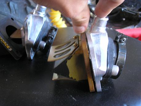

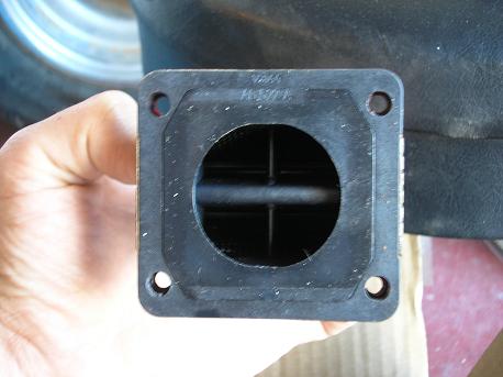

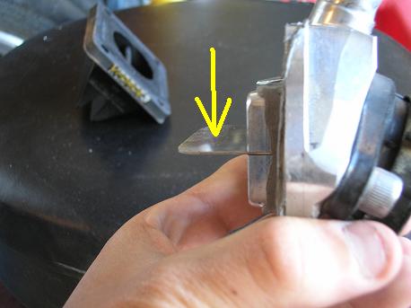

White06Shee Posted February 13, 2007 Author Report Share Posted February 13, 2007 here are the pics that im talking about 1 First pic is how it fits in the stock cage 2 second pic is how it doesnt fit in the vforce 3 third pic is that tab im talking about Quote Link to comment Share on other sites More sharing options...

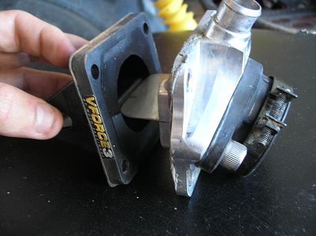

White06Shee Posted February 13, 2007 Author Report Share Posted February 13, 2007 4 forth pic is the inside of the vforce where its hitting Quote Link to comment Share on other sites More sharing options...
Tim C Posted February 13, 2007 Report Share Posted February 13, 2007 The manifolds for the V-Force reeds don't have the tab in them - your's isn't for V-Force reeds. Can you remove the tab somehow Quote Link to comment Share on other sites More sharing options...
kb7kuh Posted February 14, 2007 Report Share Posted February 14, 2007 (edited) If yours are V-Force 3's, the center section will come out. I removed mind and put a set of stuffers on and it opens them up. Looks like the plate you have won't fit inside due to that bar that goes across the reed body. I would have to look at mine to be sure. Here is a link for the stuffers so you can see how they come out. http://cascadeinnovations.net/ Go to Banshee performance, look for reeds, and click on V-force 3 Edited February 14, 2007 by kb7kuh Quote Link to comment Share on other sites More sharing options...
White06Shee Posted February 14, 2007 Author Report Share Posted February 14, 2007 i pulled the tab thing out and i ran 1/2" spacers and it works fine now. now my other question is what do the stuffers do?? Quote Link to comment Share on other sites More sharing options...
