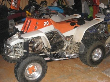

trex banshee Posted February 16, 2007 Report Share Posted February 16, 2007 Is there a orange paint that will hold up on plastic? Do you have to prime it? I was looking at the Krylon, but I didn't see any orange. yes there is, that above is just dupont orange i believe with some flex additive in it. And yes your gonna have to put some plastic primer on it also. Make sure you just prepare it really well before you spray it and it will last a long time. that orange bike, my bike, and my brother's bike are all painted. Quote Link to comment Share on other sites More sharing options...
theshee Posted February 16, 2007 Report Share Posted February 16, 2007 Nice looking bikes Trex.. Seabass, I sent you a PM. Quote Link to comment Share on other sites More sharing options...
