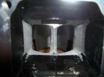

charles_in_houston Posted January 19, 2007 Author Report Share Posted January 19, 2007 (edited) your not going to gain so much throttle response from going to 28s tha your going to shit your pants... but youll notice a differance for sure..remember once you get the 4mil your going to have to get it port at the same time to change the port timings ...so plan on doing alot at one time to turn it into a stroker. as far as the unwelded crank goes its hit or miss... there not really a give away answer that this many do it and this is why... some let go fairly soon and other can go years and then let go.... I've got my eye open for a deal on the 28s now. I just missed a set on eBay for $260 plus shipping. I don't even know if that's a good deal really. As for the stroker, Bob told me the existing port work would be fine but I'd have to upgrade to another style of piston to match the port work. They way I understand it, if I was to go with the 4 mil it would only be case porting, the stroker crank (welded etc) and the new pistons. I've tried to include a photo of the intake side of the port work that Bob did. I don't know much about porting but it sure looks agressive to me and it pulls as hard as my buddies $500 port job. I am hoping that I don't have to re-do the port work again. What do you think? Edited January 19, 2007 by charles_in_houston Quote Link to comment Share on other sites More sharing options...
Bansh-eman Posted January 19, 2007 Report Share Posted January 19, 2007 (edited) I've got my eye open for a deal on the 28s now. I just missed a set on eBay for $260 plus shipping. I don't even know if that's a good deal really. As for the stroker, Bob told me the existing port work would be fine but I'd have to upgrade to another style of piston to match the port work. They way I understand it, if I was to go with the 4 mil it would only be case porting, the stroker crank (welded etc) and the new pistons. I've tried to include a photo of the intake side of the port work that Bob did. I don't know much about porting but it sure looks agressive to me and it pulls as hard as my buddies $500 port job. I am hoping that I don't have to re-do the port work again. What do you think? thats sounds about normal for them... call jeff at fast ... he can set you up with a set im sure.. hes mine and many others on here go to guy for parts... as for the porting... when you go to a 4mil your port timings change so your jugs are going to have to be redone... unless your plan is a spacer plate... you dont need anything done to the case to run a 4mil... once you move to a 7mil or bigger you got to have it trenched... im no porter so im not going to try and give advice on the pict... maybe someone thats done some porting can chime in... Edited January 19, 2007 by Bansh-eman Quote Link to comment Share on other sites More sharing options...
