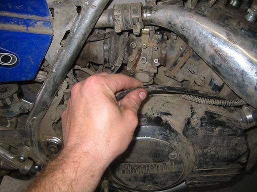

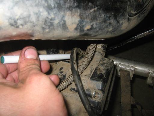

SHEEBANSAVAGE Posted May 24, 2007 Author Report Share Posted May 24, 2007 "o-ring on the pass through "..............where is that one located??? Is it what I am pointing at in the pics below? Quote Link to comment Share on other sites More sharing options...
SHEEBANSAVAGE Posted May 24, 2007 Author Report Share Posted May 24, 2007 pic 2 Quote Link to comment Share on other sites More sharing options...

dawarriorman Posted May 24, 2007 Report Share Posted May 24, 2007 (edited) OK, change the water pump seal!!!!!!!!!!! Don't post back in here until you do. Then after you do, if you still notice water in the oil, let us know. You might not think you're losing anything, but as your machine cools, it will pull some coolant from the bottle back into the radiator if needed. Thats the way its designed (sometimes it won't though). That could be why your not noticing a difference in the coolant level. The o-ring they are referring is on the tube that sticks out when you take the side case off the engine. Its right by the water pump, you'll see it when you take the side case off. Edited May 24, 2007 by dawarriorman Quote Link to comment Share on other sites More sharing options...
