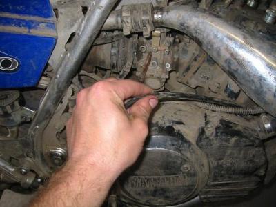

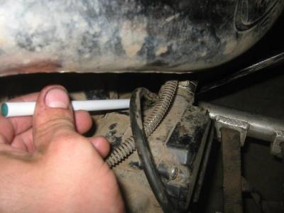

definatly its the water pump seal. thats the only place that you can get coolant into your oil. and as for the vent hose. I just put a cap on mine as it comes out of the case. really its not that big of a deal just dont over fill your oil:) when you change the seal make sure you change out the bearing as well. also if your seal has gone bad there is a good chance that you impeller shaft may have some groves in it. if so you might want to get replaced since you will have it apart.

You could've swallowed some water through a vent hose...thought the filler hole...or from a possibly bad W/P Seal...
You could've even got water in there from a pressurized quarter car wash.
My advice, replace the pump and seal, drain the tranny oil and put fresh stuff in, and keep an eye on it.
