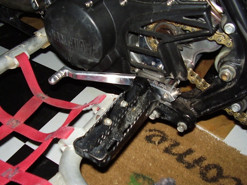

banshee tuner Posted February 16, 2006 Report Share Posted February 16, 2006 Can anyone post up pictures of raptor footpegs mounted on a shee and any fitting required. Quote Link to comment Share on other sites More sharing options...

Tim C Posted February 16, 2006 Report Share Posted February 16, 2006 (edited) Can anyone post up pictures of raptor footpegs mounted on a shee and any fitting required. 474241[/snapback] Raptor pegs will bolt on but will be back a bit so you might have to shorten your shifter and rear brake lever Here's a link to mine - it's two sets of Raptor pegs on a backing plate I made http://www.bansheehq.com/forums/index.php?...&cmd=si&img=473 Edited February 16, 2006 by Tim C Quote Link to comment Share on other sites More sharing options...
banshee tuner Posted February 16, 2006 Report Share Posted February 16, 2006 Thanks for the pictures. Quote Link to comment Share on other sites More sharing options...
