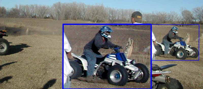

Stinger Posted February 16, 2006 Author Report Share Posted February 16, 2006 (edited) BTW bottoming out in extreme situations is pretty normal, what I mean is if you NEVER bottom out you never use ALL your travel. Which is what you pay for. you should only be bottoming in EXTREME situations and even then it should not cause a loss of control. 474055[/snapback] Here is a case of me bottoming out...doesn't seem all that extreme to me...top of second gear, ~35-40ft in the air...~4ft off the ground... Edited February 16, 2006 by Stinger Quote Link to comment Share on other sites More sharing options...

MonkeyBoy Posted February 21, 2006 Report Share Posted February 21, 2006 The 450 shocks were never designed to be on a banshee, and certainly never designed to be on a banshee with aftermerket a arms. You may never get these right, but you need to increase your compression at least. Flat ground landings like that are the worst. You will bottom those out first. Grab another gear and downside it. PS if I read that pic correctly, and those are work boots, you are in for a broken ankle too. Quote Link to comment Share on other sites More sharing options...
