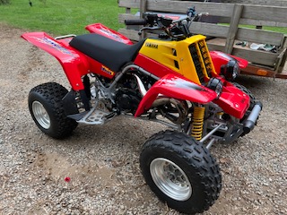

redbanshee Posted September 28, 2022 Report Share Posted September 28, 2022 I've had it! I refuse to give it away on marketplace so I'll crush it and scrap it soon if this doesn't get fixed. -bought shitbox banshee, ran, took carbs off to replace hoses, never had spark again.... -tore banshee down, full makeover, complete 370 engine, powdercoated frame, south texas banshee harness, every bushing, every bearing, 100% new quad. -ran strong for 2 hours, went to adjust carbs once day, hasn't had spark since... So far, I've... -replaced stator with new OEM unit, checked pick up coil gap, new plugs, -swapped 2 different cdi's -swapped 2 different coils -check continuity in key switch, kill switch, and every wire -tested coil, coil stator, and grounds. -my meter is even showing voltage going to the coil when the engine is turning over, however I've been told it has a pulse from the ground wire. all with zero luck no fire. This is the most unreliable POS I've ever owned, and I've had a job1 6.4 If anyone wants to chime in feel free too other wise I will crush this thing.. Quote Link to comment Share on other sites More sharing options...
