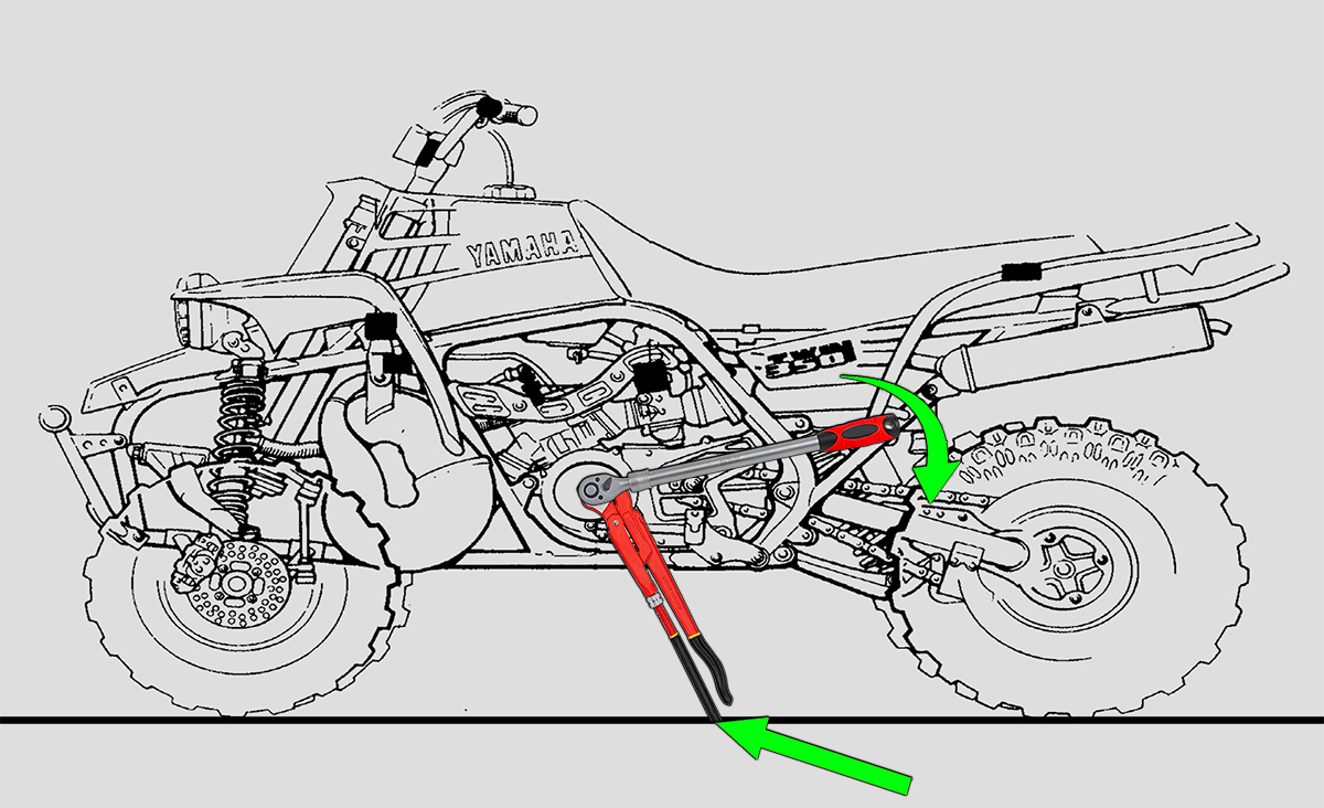

Qliphoth Posted March 17, 2022 Report Share Posted March 17, 2022 (edited) 12 hours ago, Fordmaster101 said: So there are threads on oem ones / good aftermarket ones ?. This is my first banshee. Sounds like I'm in for a long fight trying to get this flywheel off. I'll have to get a big strap wrench and a spanner wrench I've never heard of the spanner wrench but those might just do the trick i removed the flywheel too for the first time in the last week. i used the puller, a long pipe wrench to hold the puller while the handle was leaned against the floor and a long ratchet with enough leverage. only two half turns and the Flywheel came off. if you have those tools, try it! Edited March 17, 2022 by Qliphoth 1 Quote Link to comment Share on other sites More sharing options...
