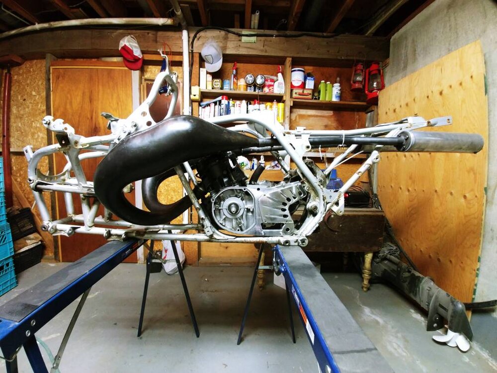

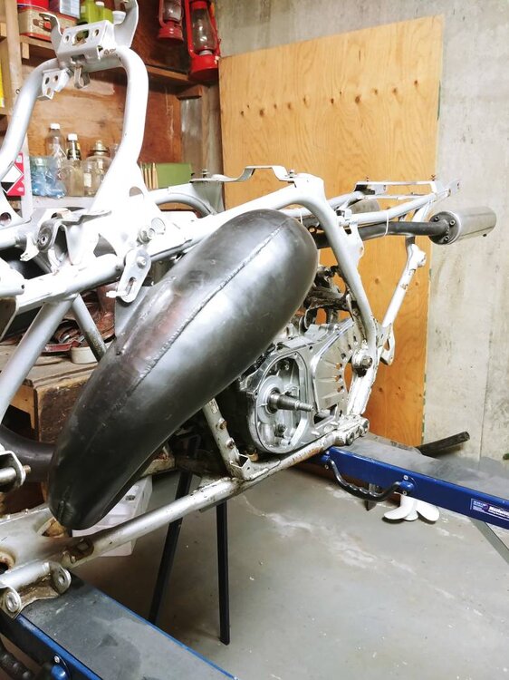

Canadianshee Posted February 27, 2022 Report Share Posted February 27, 2022 Need to put mounting tabs for silencers, or would 4 stroke silencer clamp the billet type be a better option. Sent from my LG-H873 using Tapatalk Quote Link to comment Share on other sites More sharing options...
375hp banshees Posted February 27, 2022 Report Share Posted February 27, 2022 On pipe or frame? Quote Link to comment Share on other sites More sharing options...
Canadianshee Posted February 27, 2022 Author Report Share Posted February 27, 2022 On pipe or frame?On pipe for rear silencers Sent from my LG-H873 using Tapatalk Quote Link to comment Share on other sites More sharing options...
375hp banshees Posted February 28, 2022 Report Share Posted February 28, 2022 If you dont have access to a welder, make a bracket for the silencer @ the bolts? Quote Link to comment Share on other sites More sharing options...

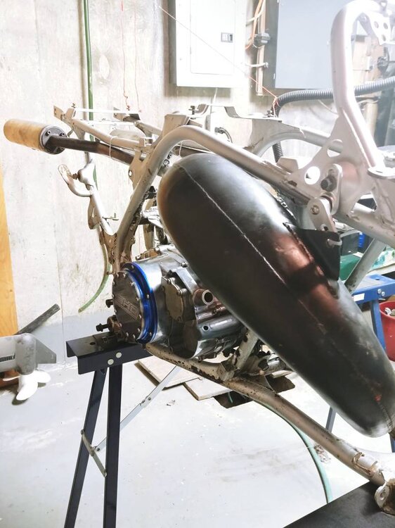

Canadianshee Posted February 28, 2022 Author Report Share Posted February 28, 2022 I Do, will prob be going that way just wanted to see if mounting other way would help prevent the welds from cracking. Looks like two times these have broken. Than again looks like Jessie may have welded them before. Sent from my LG-H873 using Tapatalk Quote Link to comment Share on other sites More sharing options...
kawa110 Posted February 28, 2022 Report Share Posted February 28, 2022 Always loved the way rockets look!!!!! Sent from my iPhone using Tapatalk 1 Quote Link to comment Share on other sites More sharing options...
375hp banshees Posted February 28, 2022 Report Share Posted February 28, 2022 8 hours ago, Canadianshee said: I Do, will prob be going that way just wanted to see if mounting other way would help prevent the welds from cracking. Looks like two times these have broken. Than again looks like Jessie may have welded them before. Sent from my LG-H873 using Tapatalk Ah, i think most solid mount the back, maybe you could insulate the mounts somehow. + the fact you'll put them where you want, might make them be in a less stressed mount/angle Speaking of jesse i see this one isnt stuffed in the time out conex. Looks like youve got plenty more work room then i thought? Quote Link to comment Share on other sites More sharing options...
Canadianshee Posted February 28, 2022 Author Report Share Posted February 28, 2022 Ah, i think most solid mount the back, maybe you could insulate the mounts somehow. + the fact you'll put them where you want, might make them be in a less stressed mount/angle Speaking of jesse i see this one isnt stuffed in the time out conex. Looks like youve got plenty more work room then i thought?Lol time out corner. Yea rubber isolation is a good idea.Sent from my LG-H873 using Tapatalk Quote Link to comment Share on other sites More sharing options...
trickedcarbine Posted April 19, 2022 Report Share Posted April 19, 2022 Your idea of using one of the round tube pipe hangers like you see on the newer 4 strokes would be the best option. My originals had welded tabs and they vibrated and cracked. Once I did them with the round tube clamps with a rubber isolator in the top bolt hole, the excess vibration went away. Way more pleasant to ride. Plenty of options from summit, jegs, and other bike/atv suppliers. https://www.budracing-usa.com/us/replacement-stainless-bracket-with-alloy-red-support-for-bud-racing-2-stroke-silencer.html Quote Link to comment Share on other sites More sharing options...
Canadianshee Posted April 20, 2022 Author Report Share Posted April 20, 2022 Your idea of using one of the round tube pipe hangers like you see on the newer 4 strokes would be the best option. My originals had welded tabs and they vibrated and cracked. Once I did them with the round tube clamps with a rubber isolator in the top bolt hole, the excess vibration went away. Way more pleasant to ride. Plenty of options from summit, jegs, and other bike/atv suppliers. https://www.budracing-usa.com/us/replacement-stainless-bracket-with-alloy-red-support-for-bud-racing-2-stroke-silencer.htmlThanks for the link, some good stuff on their sites. Will go this route. Sounds like same deal prev owner rewelded the bracket. You happen to have a pic of your old set up. Also how loud are these pipes compared to CPI's. We have new sounds limits in effect here now as to not disturb town folk. Was thinking of swapping theses with CPI Sent from my LG-H873 using Tapatalk Quote Link to comment Share on other sites More sharing options...
