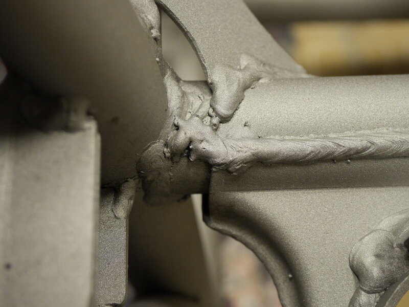

After having entirely disassembled it I stripped the frame and upon further inspection I was quite stunned by the overall quality of the welds. Please note that they're stock, no repair welding has been done.
As you can see the weld beads run rather vigurously, and not consistent at all. Sometimes the "same" welds on opposing locations in the frame look totally different. Generally, there is weld splatter all over the frame.

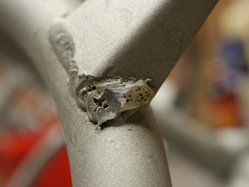

On a couple of welds there is quite a bit of porousity. I gave one a try in an attempt to re-fuse it (I'm a TIG welder), but the bead seems to be contaminated down to the metal. The below picture is stock, not reworked:

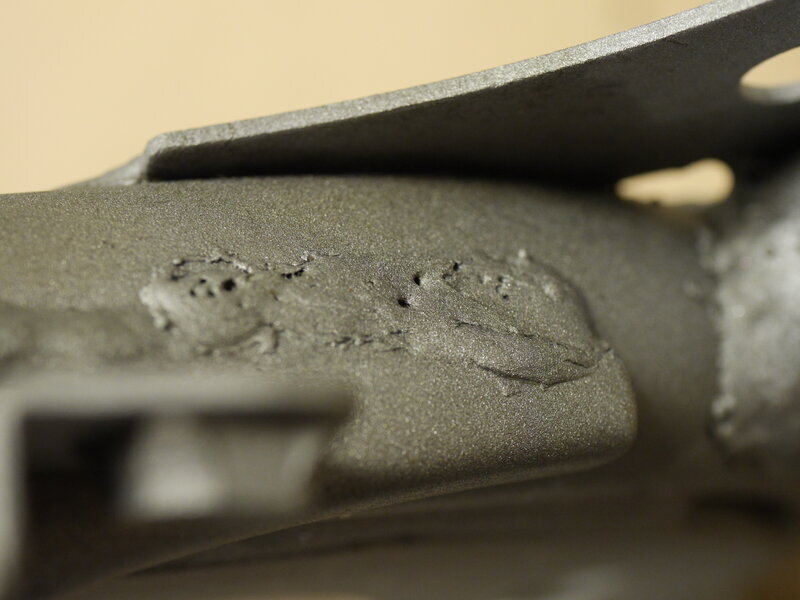

I ground down one of the larger blobs on a bead, and it is full of pores (that was not even visible until I ground it):

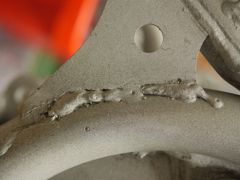

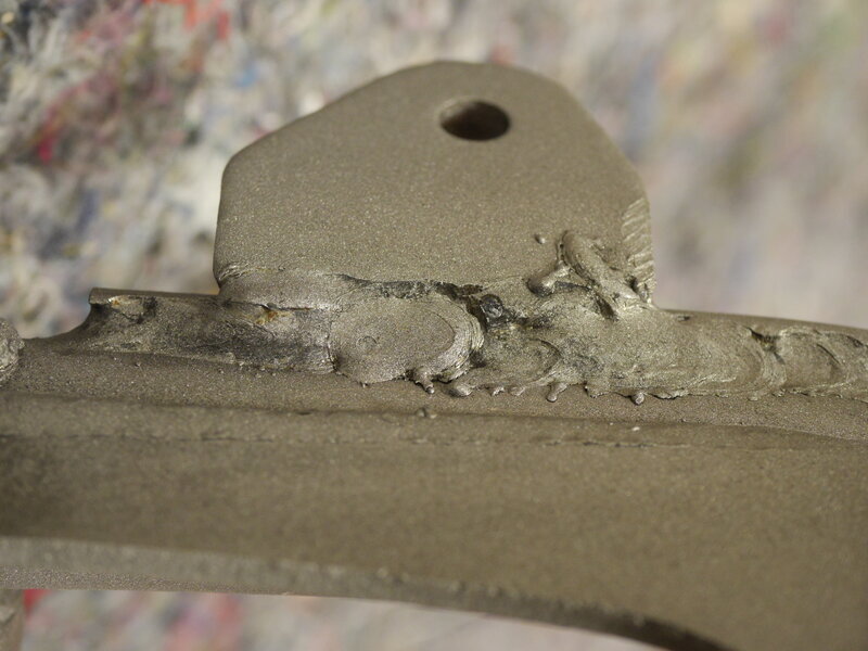

On many welds there is a lot of excess material that did not fuse anymore. Partly this only concerns the run-out of the bead, but on some welds there is a ton of un-fused material layered on top:
