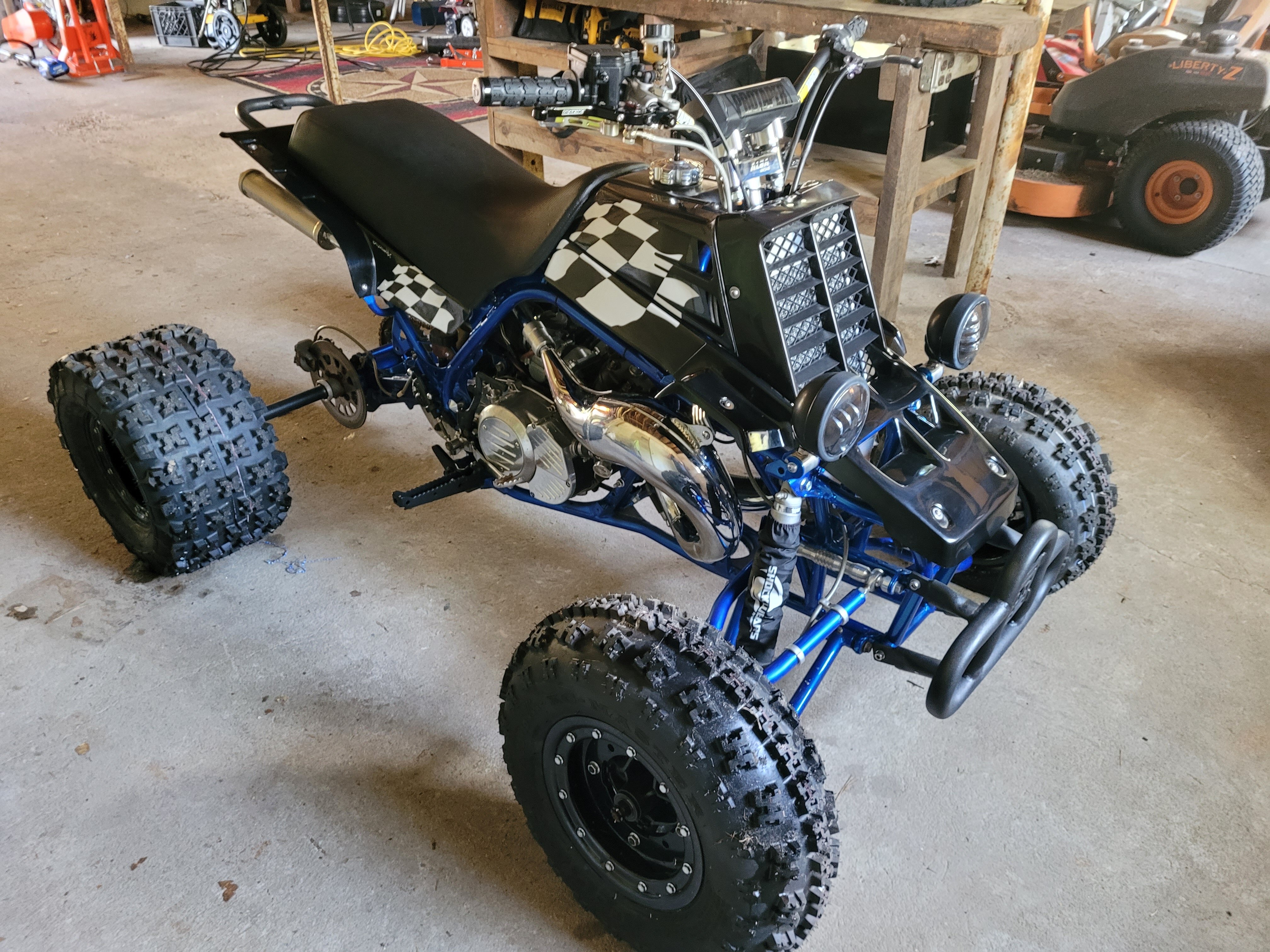

JG1 Posted July 30, 2021 Report Share Posted July 30, 2021 Haven't rode in a couple years. Had to order new calipers front and back cause they are seizing. Quote Link to comment Share on other sites More sharing options...
RagunCajun Posted July 30, 2021 Report Share Posted July 30, 2021 take that air breather off before you lean out the engine. Quote Link to comment Share on other sites More sharing options...
caleb90 Posted July 30, 2021 Report Share Posted July 30, 2021 mfga.... make fenders great again. other than that solid machine Quote Link to comment Share on other sites More sharing options...
JG1 Posted July 31, 2021 Author Report Share Posted July 31, 2021 4 hours ago, RagunCajun said: take that air breather off before you lean out the engine. What air breather are you talking about? Quote Link to comment Share on other sites More sharing options...
JG1 Posted July 31, 2021 Author Report Share Posted July 31, 2021 3 hours ago, caleb90 said: mfga.... make fenders great again. other than that solid machine Lol, thanks. I cut the rear fenders off. I like the look. Quote Link to comment Share on other sites More sharing options...
JG1 Posted July 31, 2021 Author Report Share Posted July 31, 2021 5 hours ago, DDQ said: Nice machine. Are you a trail rider? Thanks. I like trails, pits, really anything. Quote Link to comment Share on other sites More sharing options...
RagunCajun Posted August 3, 2021 Report Share Posted August 3, 2021 On 7/30/2021 at 9:58 PM, JG1 said: What air breather are you talking about? the gas cap vent line. Quote Link to comment Share on other sites More sharing options...
JG1 Posted August 4, 2021 Author Report Share Posted August 4, 2021 19 hours ago, RagunCajun said: the gas cap vent line. Won't the tank create a vacuum? Quote Link to comment Share on other sites More sharing options...
ClaudeMachining Posted August 4, 2021 Report Share Posted August 4, 2021 Won't the tank create a vacuum?Your tank need to "breathe", it need a hole somewhere, wich is your little cap.Envoyé de mon SM-N975W en utilisant Tapatalk Quote Link to comment Share on other sites More sharing options...
JG1 Posted August 4, 2021 Author Report Share Posted August 4, 2021 1 hour ago, ClaudeMachining said: Your tank need to "breathe", it need a hole somewhere, wich is your little cap. Envoyé de mon SM-N975W en utilisant Tapatalk Isn't that accomplishing the same thing as the short breather? Quote Link to comment Share on other sites More sharing options...
kawa110 Posted August 4, 2021 Report Share Posted August 4, 2021 The little breather cap on hose can clog and or fail. Remove it, let tank vent “freely” Remove check valve from the stock cap as wellSent from my iPhone using Tapatalk Quote Link to comment Share on other sites More sharing options...
Keno Posted August 4, 2021 Report Share Posted August 4, 2021 Just run a hose from the cap and angle it down like stock. The tiny breather has a ball to act as a check valve and as oil and dirt mix in the check valve area, it gets plugged. This creates a vacuum in the tank leading to your carburetor bowls running dry, leading to a stuck piston. It's happened enough that it is ingrained into everyone to point out how bad those are. 1 Quote Link to comment Share on other sites More sharing options...
JG1 Posted August 5, 2021 Author Report Share Posted August 5, 2021 7 hours ago, Keno said: Just run a hose from the cap and angle it down like stock. The tiny breather has a ball to act as a check valve and as oil and dirt mix in the check valve area, it gets plugged. This creates a vacuum in the tank leading to your carburetor bowls running dry, leading to a stuck piston. It's happened enough that it is ingrained into everyone to point out how bad those are. Gotcha Quote Link to comment Share on other sites More sharing options...
autitord Posted August 25, 2021 Report Share Posted August 25, 2021 On 8/5/2021 at 5:46 AM, Keno said: Just run a hose from the cap and angle it down like stock. The tiny breather has a ball to act as a check valve and as oil and dirt mix in the check valve area, it gets plugged. This creates a vacuum in the tank leading to your carburetor bowls running dry, leading to a stuck piston. It's happened enough that it is ingrained into everyone to point out how bad those are. Hope everything's working perfectly by now. Your Banshee looks great! Quote Link to comment Share on other sites More sharing options...
