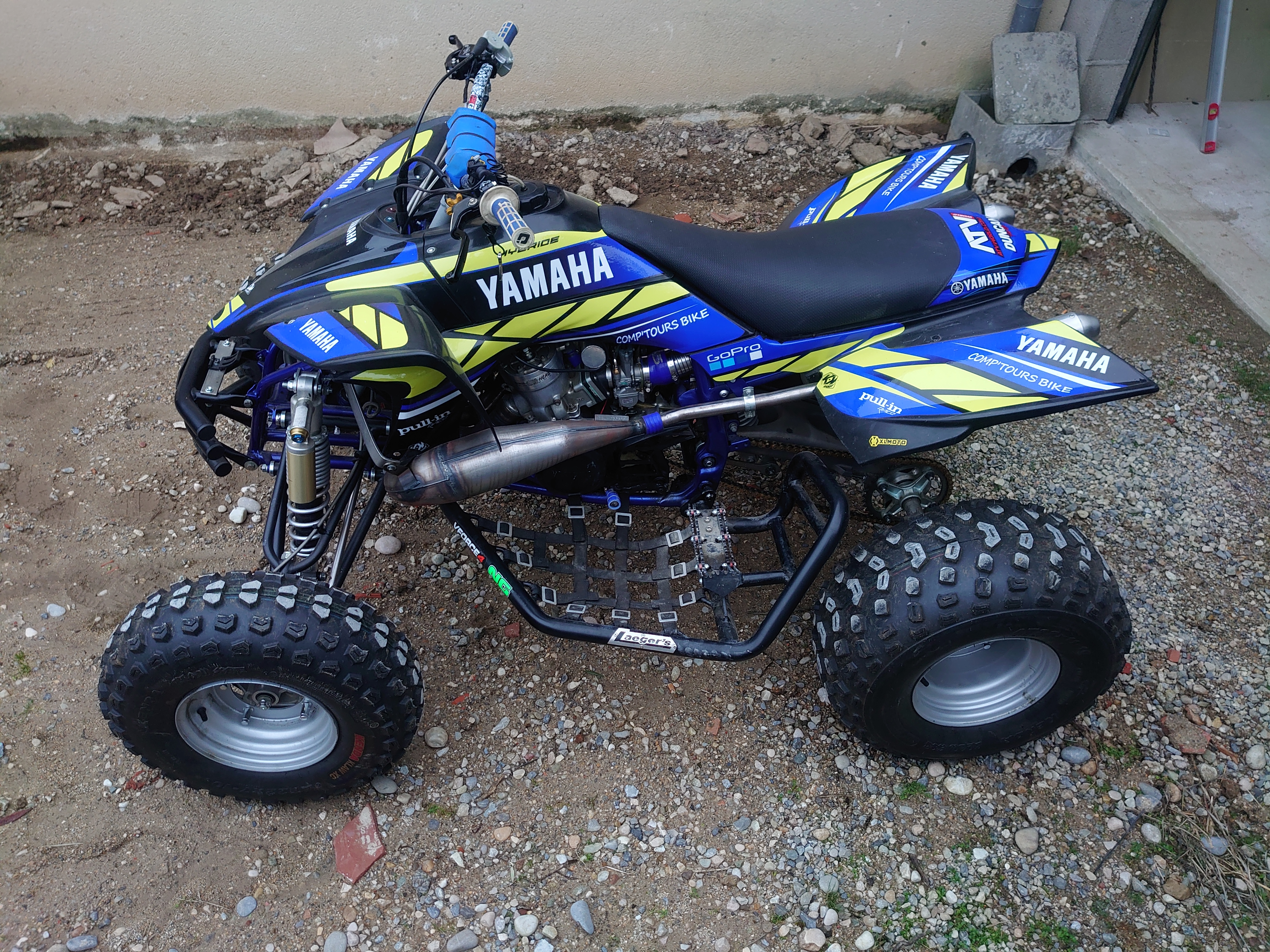

Hello les copains je me présente Seb ...j ai un hybride yfz complet avec moteur de banshee
Savez vous si les plastiques du banshee  peuvent être installé sur le cadre yfz 450 au moins la face avant ?
Merci

To make it look good you’d pretty much need a full set of plastics, tank, seat and the patience and skills to fabricate all the mounting points
Changing the front will have a knock on effect... The banshee front will not match up to the yfz tank, so you’ll need a banshee tank the banshee tank will not match up to the yfz seat and so on. Very expensive and even more time consuming
BUT!
If you do it you at least you will look fast as fuck boiiii
