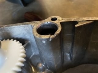

Tarrenitup82 Posted February 23, 2020 Author Report Share Posted February 23, 2020 I have an o ring kit so I put a new o rinf on the transfer tube and then out about a liter of transmission fluid in it. It’s no coming from the vent hoses when I let it just run and reved a few times but is still coming from the block where the transfer tube comes out. So you think clutch gasket and new cover because of the gauge in mine? That’s all I can think of beside a crank seal Quote Link to comment Share on other sites More sharing options...

Tarrenitup82 Posted February 23, 2020 Author Report Share Posted February 23, 2020 Also when I blow into the one of the vent tubes and plug the other it starts to leak oil from the transfer tube spot I was talking about. Leaks in between the tube and block or case so I do believe it would be the cover. Opinions Quote Link to comment Share on other sites More sharing options...
375hp banshees Posted February 23, 2020 Report Share Posted February 23, 2020 Yes by doing that there's no venting going on and oils going to go out any leak. if your doing it with it off, that area must have trapped oil, from before. I wouldnt think there would be oil there unless slung up there while running, by getting by gouge. With That being Said, make sure you clean that cavity between the tube and cases so when ur done there's no Residual and you think it's not fixed Sent from my SM-A505U using Tapatalk Quote Link to comment Share on other sites More sharing options...

Tarrenitup82 Posted February 25, 2020 Author Report Share Posted February 25, 2020 My buddy let me test his cover out and it leaked out the rear vent for a couple minutes then suddenly stopped. After wards I tried to make it do it again and it wouldn’t. Even did a couple wheelies and 6 gear wot. Nothing so I hope it’s fixed. I got myself a new cover and new gasket Quote Link to comment Share on other sites More sharing options...
