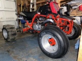

Tarrenitup82 Posted February 17, 2020 Report Share Posted February 17, 2020 Hello new to the page. My bike ran perfectly fine but leaked some gas from the carbs so I got a rebuild kit. I kept all the jets that were inside it because I have cool heads, vforce reeds, and t5 pipes and silencers. I’ve got 330 main and 27.5 pilot, with air box delete and tors delete. When I’m in neutral or with the clutch pulled in it runs fine and I can rev it no problem. As soon as I start to release the clutch and it begins to engage the bike starts to bog out and die, but If I rev it up and take off it will run fine and I can get into power band but as soon as I slow down and start to use a little throttle it bogs?!?! Quote Link to comment Share on other sites More sharing options...
