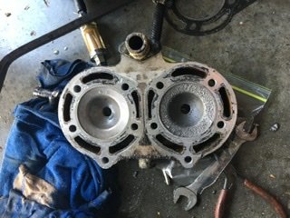

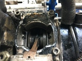

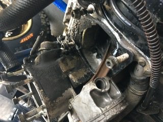

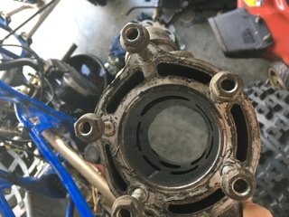

HomesteadBanshee Posted February 14, 2020 Author Report Share Posted February 14, 2020 Yeah took it apart I’m sure ima need a full rebuild top aswell the bottom end . The bottom half of the piston literally broke so there’s chunks all over the case in the bottom end I’m sure ima have to take the cases apart and go through everything and get rid of all the metal scraps that are in the bottom end from the piston exploding. Quote Link to comment Share on other sites More sharing options...

HomesteadBanshee Posted February 15, 2020 Author Report Share Posted February 15, 2020 I need new crank,new pistons I need to bore the cylinders, new head, I basically need a new build.any builders or sponsors give a discount being a hq member? Quote Link to comment Share on other sites More sharing options...
