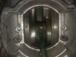

DoubleJay Posted January 24, 2020 Author Report Share Posted January 24, 2020 Got it apart. Little bit of rust in left side of engine and in jug Quote Link to comment Share on other sites More sharing options...

DoubleJay Posted January 25, 2020 Author Report Share Posted January 25, 2020 I’m hoping bottom end is ok. Cylinder walls are not damaged . Maybe I can re use jugs. Is head too far gone? Pistons are marked WSM... guessing that means wiseco??? Quote Link to comment Share on other sites More sharing options...
trumanbuckley1 Posted January 25, 2020 Report Share Posted January 25, 2020 I’m hoping bottom end is ok. Cylinder walls are not damaged . Maybe I can re use jugs. Is head too far gone? Pistons are marked WSM... guessing that means wiseco???Not to be mean but is your camera smudged? Pics are kind of blurry. Just looking at the head, mine looked similar and I reused it. I took a hammer and punch and made sure to peen it all smooth again and knock off any loose chunks. Do your rods have any side to side play? Like angular side to side play. Any numbers on the pistons? There should be numbers on the tops that say what the bore is.Sent from my iPhone using Tapatalk Quote Link to comment Share on other sites More sharing options...
DoubleJay Posted January 25, 2020 Author Report Share Posted January 25, 2020 Rods are good . Slight side to side play but no angular or up and down. Pistons are 50-520-07P 1.00 1 Quote Link to comment Share on other sites More sharing options...
