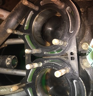

dano3 Posted November 25, 2018 Report Share Posted November 25, 2018 5 minutes ago, 2 jugs are better than one said: Ok good to hear that’s what I was hoping to hear. I’m not gonna mess with anything tell spring now, I want warmer temps and if it runs good come that time I would like to do the tors delete bc that crap on top is a pain in the a$$ wow! as for pictures they look crappy when I resize them but the walls were spotless! The top of the pistons looked like coffee stain color and smooth 👌 also yes I did get my hands on flat o rings for both carb caps 👍 also screws were around 1.5 turns out prior to this all. OK, if you have jetting to compensate for the colder temps it would be fine but first step is to determine what your jetting is lol. TORS delete kit makes everything easier for sure. And i wanted to see the pistons to see if the lower compression side has signs of pitting from being lean but sounds like they didnt. Quote Link to comment Share on other sites More sharing options...
2 jugs are better than one Posted November 25, 2018 Author Report Share Posted November 25, 2018 7 minutes ago, dano3 said: OK, if you have jetting to compensate for the colder temps it would be fine but first step is to determine what your jetting is lol. TORS delete kit makes everything easier for sure. And i wanted to see the pistons to see if the lower compression side has signs of pitting from being lean but sounds like they didnt. I got the picture to work now 👍 check it out above Quote Link to comment Share on other sites More sharing options...
dano3 Posted November 25, 2018 Report Share Posted November 25, 2018 2 minutes ago, 2 jugs are better than one said: I got the picture to work now 👍 check it out above hard to tell but looks ok. no melting on the edge of the piston near the exhaust port right? Quote Link to comment Share on other sites More sharing options...
2 jugs are better than one Posted November 25, 2018 Author Report Share Posted November 25, 2018 3 minutes ago, dano3 said: hard to tell but looks ok. no melting on the edge of the piston near the exhaust port right? 3 minutes ago, dano3 said: hard to tell but looks ok. no melting on the edge of the piston near the exhaust port right? No it was smooth all around both cylinders and pistons. On another note my issue of fuel coming from the over flow that was not adjusted at all but I put new float valve/seal all in it and it’s doing the same thing still. Think it will fix itself this coming summer and flush out while riding our should I pull them dang carbs for the 3rd time 🤪.. also what about a inline fuel filter? And if so what microns would be good to keep any sand/crap out? Quote Link to comment Share on other sites More sharing options...
dano3 Posted November 25, 2018 Report Share Posted November 25, 2018 2 minutes ago, 2 jugs are better than one said: No it was smooth all around both cylinders and pistons. On another note my issue of fuel coming from the over flow that was not adjusted at all but I put new float valve/seal all in it and it’s doing the same thing still. Think it will fix itself this coming summer and flush out while riding our should I pull them dang carbs for the 3rd time 🤪.. also what about a inline fuel filter? And if so what microns would be good to keep any sand/crap out? If you dont have any air leaks your lean condition is either from a fuel supply issue/plugged jet or passage, or caused by jetting and temp changes. I would pull the carbs and really go through them and clean all the passages and make sure float height was set correctly. especially since you dont know what jets you are running. When i clean carbs i pull out all the brass and blow carb cleaner through every passage i can get too using the straw on the spray nozzle. If you have junk in your tank then drain/flush it out and fill with fresh mixed fuel. I dont run a fuel filter to ensure i dont restrict fuel flow but maybe someone else can share their experiences with them. I have seen them for sale on FAST racing so if you really think you need one then buy that one. Quote Link to comment Share on other sites More sharing options...
2 jugs are better than one Posted November 25, 2018 Author Report Share Posted November 25, 2018 9 minutes ago, dano3 said: If you dont have any air leaks your lean condition is either from a fuel supply issue/plugged jet or passage, or caused by jetting and temp changes. I would pull the carbs and really go through them and clean all the passages and make sure float height was set correctly. especially since you dont know what jets you are running. When i clean carbs i pull out all the brass and blow carb cleaner through every passage i can get too using the straw on the spray nozzle. If you have junk in your tank then drain/flush it out and fill with fresh mixed fuel. I dont run a fuel filter to ensure i dont restrict fuel flow but maybe someone else can share their experiences with them. I have seen them for sale on FAST racing so if you really think you need one then buy that one. Ok thank for all the help man💯 Quote Link to comment Share on other sites More sharing options...
