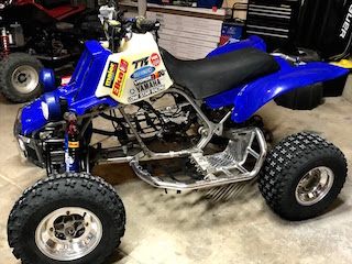

New to the BansheeHQ forum here. I recently picked up a used 2005 Banshee. My plan is to build an MX Banshee for (somwhat) cheap! Here is what is looks like now:

Here is the Banshee all stock on day 1:
Let me know what you think! Open to suggestions :)

FFS, yfz450. Really? This is going to be a great MX quad with yfz450 shocks and spacers.
Don't buy the boost bottle, it will just be anther reason your quad doesn't finish the race.
You don't need skid plates for MX.
Ditch the T5 pipes for something that is more MX friendly such as PT mids.
A steering damper will be helpful, especially with those wheel spacers adding tons of bump steer.

Funny part, stock suspension is 100x better than yfz450 shocks and wheel spacers. Run shocks that are too long for your a-arms will cause the ball joints to be in extra stress. Running wheel spacers puts everything in extra stress.

Dont get this the wrong way....  but All those parts you listed  that i left above in the list there arn't needed.
Ok subtract the skids as you trail ride... i get it...
you still have a long list of wasted money on cosmetic stuff you really dont need...when you could be investing in what actually would make a night and day difference
You mention MZS clutch and brake levers when you already have MSR's...
FMF boost bottle is useless - do yourself a favor and just use the stock cross over.
Gas cap?  it don't do anything beside looks... and your in dire need of proper suspension by a long shot
front bumper and rear grab bar.. again cosmetic... your stock stuff is clean... suspension trumps them 1020%
Hide a key?   F the key delete it... you have a tether...just keep the tether with you and no one will be able to start the bike if your worried
Temporary spacers where a complete waste of cash and time.. you would of been  just as good with the standard width as is for the time being until your parts came in.
Aftermarket plastics.....
With all that wasted money... it would of paid for a set of decent PROPER shocks...  or damn close to it.
I'd buy alba arms and proper shocks before buying LSR arms and running YFZ shocks...
You could of also cut expenses at the axle...  LSR axle is about 350... RMATV tusk axle is 200 shipped and offer a lifetime warranty as well. also the tusk comes with a proper locking nut that doesnt come loose after a couple rides like most aftermarket nuts do on aftermarket axles.
Just saying.. suspension goes a long way... and when most guys on here see people pissing away cash in areas not needed and then get replies like "suspension isnt in the budget or too expense"  but then look at the more so useles trailer queen parts they bought that exceed the cost of proper shocks is mind blogging....
