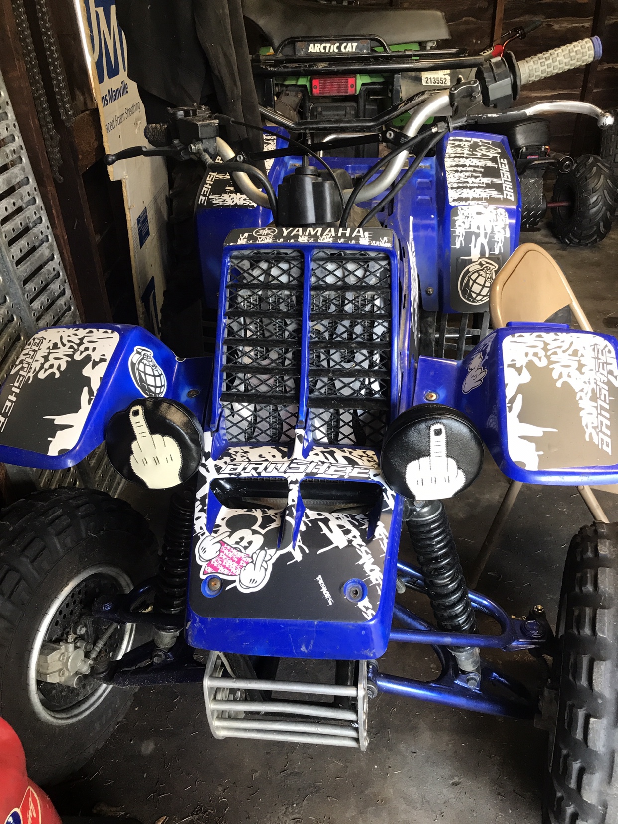

hicksons Posted August 30, 2017 Report Share Posted August 30, 2017 What's going on guys ,I just finished my friends banshee and when I turned it on the bike seems to lag down low but up top she clears out and rips he has open air box lid and toomy t5 wondering what the issue can be Sent from my iPhone using Tapatalk Quote Link to comment Share on other sites More sharing options...
ginger Posted August 30, 2017 Report Share Posted August 30, 2017 pilot jet, or needle position most likely. Quote Link to comment Share on other sites More sharing options...
hicksons Posted August 30, 2017 Author Report Share Posted August 30, 2017 Just off the little things he has what pilot and what number clip should it be ,stock carbs also minukiSent from my iPhone using Tapatalk Quote Link to comment Share on other sites More sharing options...
ginger Posted August 30, 2017 Report Share Posted August 30, 2017 normally i think people put a 27.5 pilot. and run the second from the top clip. but dont hold me to it. i havent played with stock carbs in prolly 4 or 5 years. Quote Link to comment Share on other sites More sharing options...
hicksons Posted August 30, 2017 Author Report Share Posted August 30, 2017 Ok cool I will do that after work today Sent from my iPhone using Tapatalk Quote Link to comment Share on other sites More sharing options...
