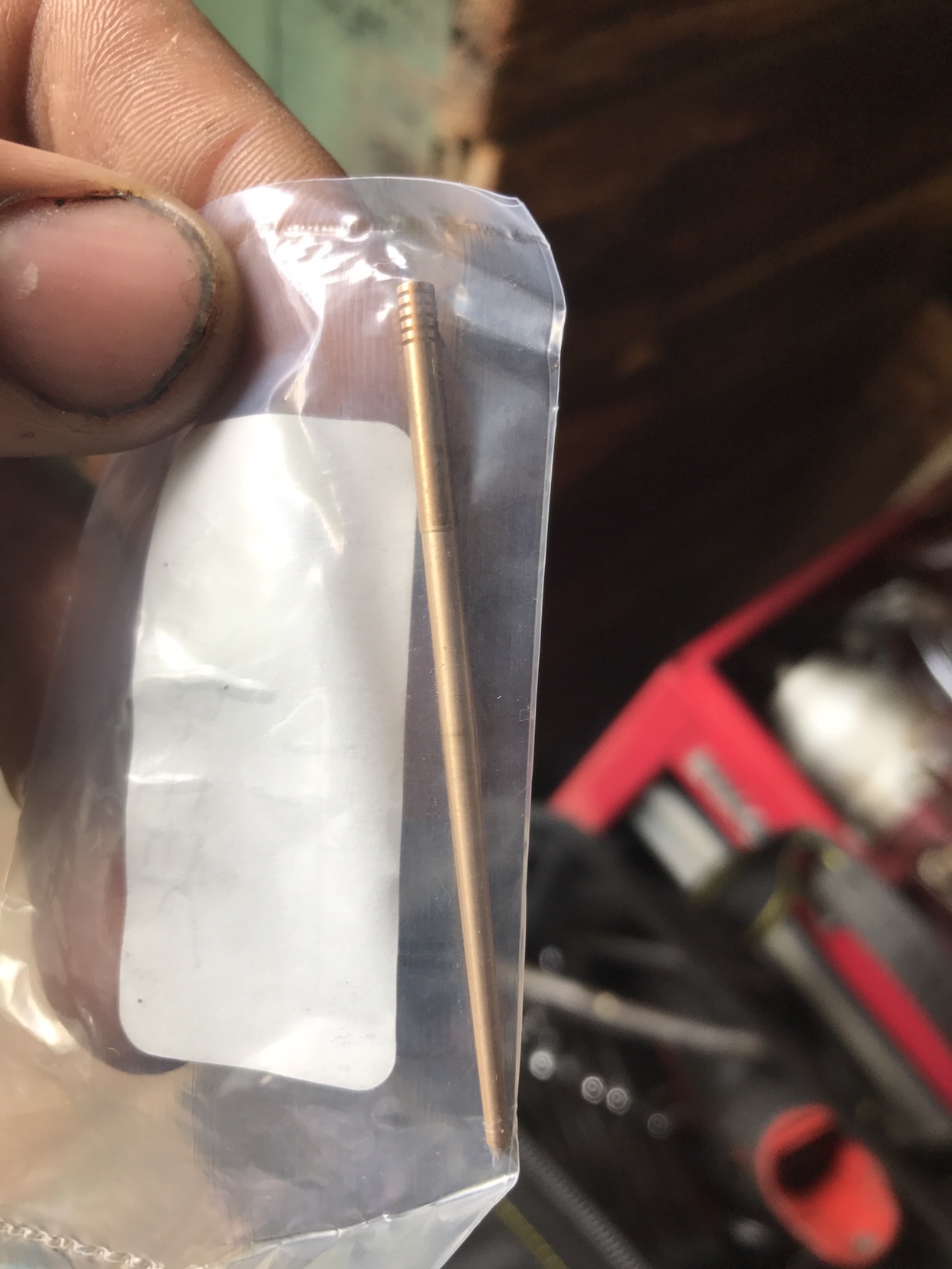

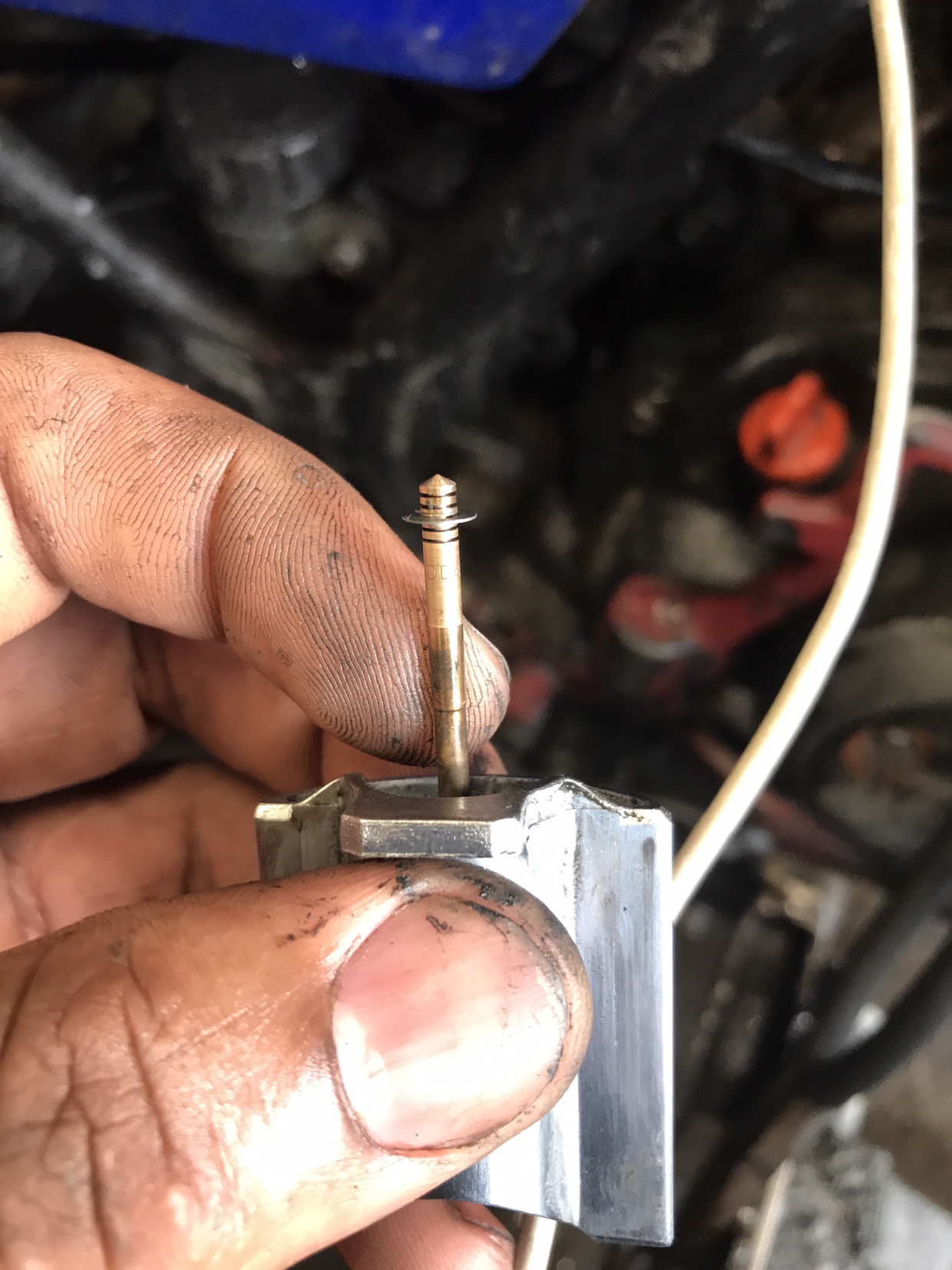

The needle brand really makes tht kind of difference , I'm actually really interested I perfecting the banshee I'm good at my yfz,Ltr,raptors but I really want to be able to dial a banshee in perfect I'm always gunna be a student of the sport and craft

Can't make out letters, what does it say. Yes the needle effects the widest spectrum of tune . If you want knowledge go on keihin website and start reading about the needle selection. Each letter on the needle effects different throttle positions . That's the difference between good and great
