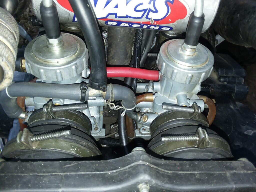

So I got the banshee to my garage guys and found that the bike doesn't even have to be rolling if you sit at idle in neutral and rev when it gets up there in Rpms it starts to break down sputter idle it smokes and pings out both exhaust and high up in rpm one cyl will smoke and the other won't so much little smoke nothing like the other side

Which side is smoking more? What about the stator? Is it OEM ? I see you have a boost bottle pushed all the way down in the boots with OEM clamps. That's an almost guaranteed air leak there. Did you leak test it? I wouldn't fool with a boost bottle at all but f you have no choice then get some hose clamps from the auto parts store and use them instead but most importantly you need to leak test it asap. I would be surprised if there is no leak at the bottle
