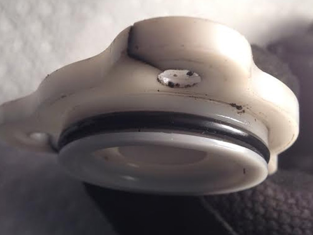

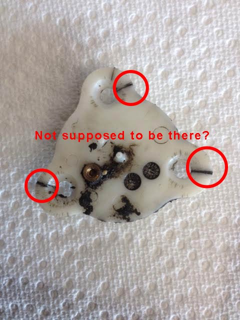

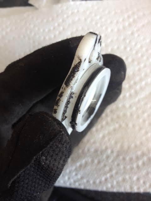

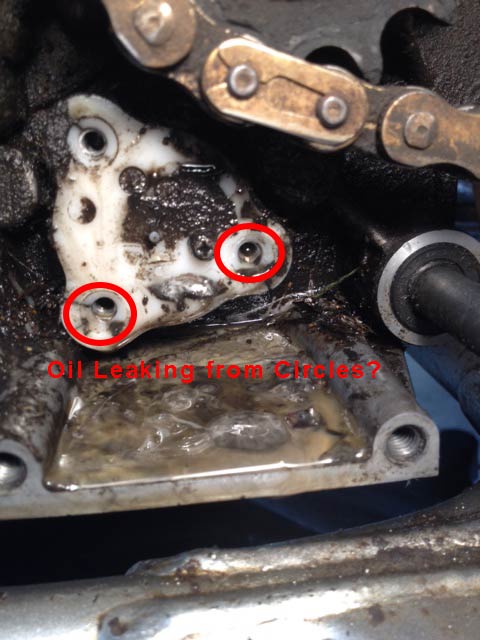

Finally got out to the garage.
Not the shifter seal.  As shown in attached photo, it's dry.  Appears to be leaking from the two bottom bolts where the case saver bolts in.
Anyone ever had this happen?  Any ideas?  I've never run into this before.  Photo attached.
thanks.
