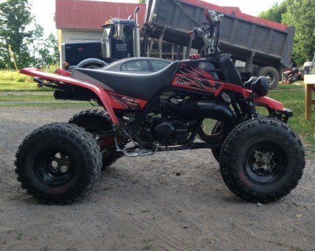

Canadianshee Posted January 17, 2017 Report Share Posted January 17, 2017 Greeting all I have reading post on here for some time to get some ideas for repairs and upgradded on my recent purchase. New owner of a 2007 Banshee with very little mods done other then pipes, which are CPI small bore inframe. This bike works great starts first kick but does not pull 6th or 6th gear. Just makes a hollow sound. (Prob pipes) So since I like to know the state of my used toy, I decided to do a full tear down. I did find a very odd carborator set up. Both carbs had different size main jets in them and the needle clip was set two positions different then the other. I'm new to dual carb bike but pretty sure that's not right. From all my reading on here I have ordered and received the following 1. New cylinders with MX Hardcore porting, cool head with domes for pump gas, true and welded crank(Thank you Kevin Herr). 2. CFM air box and filters 3. Chariotte Performance reed cage, Instake with built in crossover, clutch pancake bushing clutch adjuster thing, Neutral switch cover, easy drain water pump cover. (Thanks Jerry) 4. Mull engineering water pump gear, high flow water empellar, shift star, and shift star linkage bearing. I will be replace all seals and gasket for both upper and lower ends and replacing any worn motor parts once inside. It goes without say that all chassis, wheel bearings ECT will be replaced after powder coating. 5. FMF Fatty pipes and silencers ( CPI for future) I there anything else that this community vast knowledge knows about before I get right into the rebuild that should also look at. I am on the hunt for new a-arms and shocks just not sure as of yet new or lightly used. I'm from Central Ontario Canada so trying to find aftermarket parts is tough, so if any other Canadian members know of places for parts let me know. Or any of the site sponsors have dealers here in Canada. Thanks in advance for any and all information. Sent from my LG-H831 using Tapatalk Quote Link to comment Share on other sites More sharing options...
