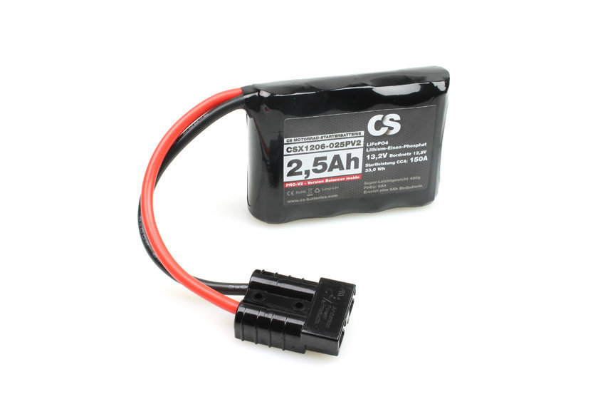

Qliphoth Posted April 15, 2020 Report Share Posted April 15, 2020 (edited) has someone experience with Lithium ion batteries? but these thingies have no "memory effect", so i'm not sure about that, if a Speedometer could run with it. I have no battery installed too and my plan is, to run my Trail Tech Endurnance II with such a battery at least, because it is small and no further alterations on the rear fender is needed. i have also four frickin winkers and an extra backlight installed, because it is a must have. you can install that 12V ion battery like any other motorcycle battery and connect to the Stator/regualtor, but also standalone and later recharged with a charger if power is low. what are your thoughts on this solution? Edited April 15, 2020 by Qliphoth Quote Link to comment Share on other sites More sharing options...
375hp banshees Posted April 18, 2020 Report Share Posted April 18, 2020 Stand alone , You cant hook that to your stator ( unless it's been dc converted) the stator is a.c. Try it stand alone for trailtech only & see if the results are what you are looking for Also alot of people are using power tool batteries fyi 1 Quote Link to comment Share on other sites More sharing options...
Qliphoth Posted April 20, 2020 Report Share Posted April 20, 2020 my plan was actually, to run the Speedometer with that battery only without connecting it to the stator ect and charging it manually later. maybe crackpot idea lol Quote Link to comment Share on other sites More sharing options...
375hp banshees Posted April 20, 2020 Report Share Posted April 20, 2020 No, thats what i'd do ...at first Sent from my SM-A505U using Tapatalk Quote Link to comment Share on other sites More sharing options...
