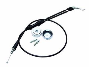

dirtrider305 Posted June 5, 2016 Report Share Posted June 5, 2016 hello banshee hq i pretty new to 2 strokes i have a question i want to clarify i have tors on my banshee and want to eliminate them my mecanic said that i dont need the idle screws all i need is the cable with the tops is that true??! Quote Link to comment Share on other sites More sharing options...
hoppedupandcutdown Posted June 5, 2016 Report Share Posted June 5, 2016 Get it with the idle screws. Install the idle screws. Consider new mechanic. Life will be so much easier. 2 Quote Link to comment Share on other sites More sharing options...
sheerider11 Posted June 5, 2016 Report Share Posted June 5, 2016 Get it with the idle screws. Install the idle screws. Consider new mechanic. Life will be so much easier. This. Quote Link to comment Share on other sites More sharing options...
Larry's Shee Posted June 5, 2016 Report Share Posted June 5, 2016 Adjusters on cap are for slack and syncing both sides. Idle screw is for setting idle Quote Link to comment Share on other sites More sharing options...

trickedcarbine Posted June 5, 2016 Report Share Posted June 5, 2016 Your mechanic is kind of a hack. It can be made to work with out them, but it's so much better with the actual screws. Get the screws and a new mechanic. Quote Link to comment Share on other sites More sharing options...
