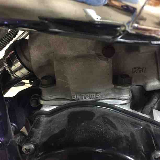

Bottlefed07 Posted June 5, 2016 Author Report Share Posted June 5, 2016 Shows that it's at 54mm Quote Link to comment Share on other sites More sharing options...
Bottlefed07 Posted June 5, 2016 Author Report Share Posted June 5, 2016 Here is is this is y it dosnt make sense to me hey measured for and it came to 54 mm Quote Link to comment Share on other sites More sharing options...
Larry's Shee Posted June 5, 2016 Report Share Posted June 5, 2016 Reason you want to rebuild? Low on compression? Quote Link to comment Share on other sites More sharing options...
bigweav81 Posted June 5, 2016 Report Share Posted June 5, 2016 That's crazy, and looks to be thick af. Sent from my SM-S820L using Tapatalk Quote Link to comment Share on other sites More sharing options...
bigweav81 Posted June 5, 2016 Report Share Posted June 5, 2016 Looks like the outside transfer walls on the side of the cylinders have been built up maybe. On a stock stroke crank with barrels raised that much would significantly lower compression, and your port timing would be way off. Sent from my SM-S820L using Tapatalk Quote Link to comment Share on other sites More sharing options...
bigweav81 Posted June 5, 2016 Report Share Posted June 5, 2016 It would be interesting to take your head off, and take pics of pistons at tdc, and bdc. Sent from my SM-S820L using Tapatalk Quote Link to comment Share on other sites More sharing options...
trickedcarbine Posted June 5, 2016 Report Share Posted June 5, 2016 Umm, there is a lot of work goin there! I'd bet it is 7mm or more of stroke. That is a pretty large plate and those transfers have been welded. That's a pretty retro set up by today's standards, but I bet it runs like a raped ape on a fresh rebuild and decent tune up. Quote Link to comment Share on other sites More sharing options...
BANSHEE HP Posted June 5, 2016 Report Share Posted June 5, 2016 Stock stroke long rod.... 1 Quote Link to comment Share on other sites More sharing options...
Bottlefed07 Posted June 5, 2016 Author Report Share Posted June 5, 2016 Yea it's the fastest 365 I've ever seen before and it just dosnt have the power it use to that's y I wanna rebuild only has 135 psi a hole and when I got it it ran 180 a hole and I only use it for dirt drag Quote Link to comment Share on other sites More sharing options...
