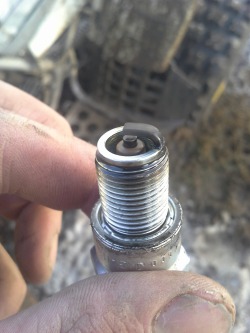

Buckwheat98 Posted March 12, 2016 Report Share Posted March 12, 2016 (edited) Hey, could some of the pros take a look at my spark plugs. I recently installed a set of fmf fattys with toomey t6 silencers on my banshee. I am running the stock air filter and air box with the snorkel removed. I installed a set of 260 mains and 27.5 pilots. The needles are in the stock position. The altitude I ride at ranges from 2500-3000 feet. The temperature at the time of the photos was 8 degrees Celsius but in the summer temps range from 20-40. The pictures show a fresh set of plugs after riding the bike wide open for a mile down a gravel road. Just wanted some opinions because i really dont feel like melting a piston anytime soon. Thanks in advance Edited March 12, 2016 by Buckwheat98 Quote Link to comment Share on other sites More sharing options...
rjdgriff Posted March 12, 2016 Report Share Posted March 12, 2016 Looks plenty rich. Not going to lean out like that! Trail bikes, FTW Quote Link to comment Share on other sites More sharing options...
sleeper06 Posted March 13, 2016 Report Share Posted March 13, 2016 If it feels good leave it alone with those mods prob closer to a 240 main but stringing it out for a mile it needs extra fuel Quote Link to comment Share on other sites More sharing options...
