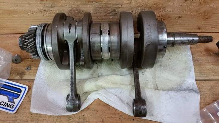

How cheap and what's the condition, there's a reason it's few and far between you see anything about em on this site , and a reason no builder will recommend it .more food for thought the crank is the heart of your engine , treat your heart good and it will treat you good . The added stroke with short rod put unneeded stress on the piston skirt . Don't say I didn't worn you

Like 140 cheap. Guy says it came in and engine he got so condition is unknow but it looks good... So will the piston hit the cases is that where your saying it's hard on the skirt

You wanna try something diffrent for trail riding, stock stroke long rod with torque porting , boost porting , high compression, race gas , some timing . Power everywhere. I've rece built a few and they are fun and rev excellent
What ya think on looks

just wanting to try something different after people specifically told you to do longrod to me says i wanna be cheap and waste money on some second hand parts that probably wont last. Get a brand new hot rods long crank, get a good supporting vendor to port it, and ride it.

I've had a long rod before yes...but I didn't know if the short rod would work like a stock crank instead...reason for my questions. And sleeper also,said he's built these before and had one kick around for 3 years... I'm jus seeing what others ppl thoughts are

Well that's what I was asking if I do short rod crank to make a stock cylinder 4mil trail bike if ppl like it.. I mean figure ppl had some good input either they tried it and liked it or no
