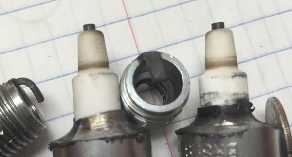

Gumball12 Posted May 13, 2015 Report Posted May 13, 2015 Posted this on 4mil serval post but looking for feedback Quote
RadarRacing Posted May 13, 2015 Report Posted May 13, 2015 Good and safe lookin to me. If you are greedy it still looks slightly rich. 1 Quote
Gumball12 Posted May 13, 2015 Author Report Posted May 13, 2015 Thanks no drag race here.. I want to play safe for now 1 Quote
RadarRacing Posted May 13, 2015 Report Posted May 13, 2015 If it is beer bottle brown and not black then you are good. It looks slightly black but pics dont always show color the same as your eyes in person. Beer bottle brown is easy to remember. Beer is good. Lol. 1 Quote
Gumball12 Posted May 13, 2015 Author Report Posted May 13, 2015 I was thinking it was light but that could also be being paranoid beer bottle brown it is the 162 would have worked but for now I am safe with 165. Thanks for all your input RR! I think now I am rich on the needle jjh middle clip, plugs got dark fast in the middle messing around the yard. Runs great though. Better than i imagined Quote
RadarRacing Posted May 13, 2015 Report Posted May 13, 2015 If you lean out the needle remember that leans out everything a little. I would jump up to the bigger main maybe depending on what it looks like with another chop. Dont be lean on the topend. Beer bottle brown ring the thickness of a nickle is always 2 or 3 jet sizes safe/rich when I have tuned on the dyno. Glad it runs good. Quote
Gumball12 Posted May 13, 2015 Author Report Posted May 13, 2015 If I am a little rich on main now (little) one clip on the needle might just get me perfect? Quote
Strm Trpr Posted May 13, 2015 Report Posted May 13, 2015 If I am a little rich on main now (little) one clip on the needle might just get me perfect? Try it and let us know. Clips on 2nd from blunt end of needle, correct? Quote
Gumball12 Posted May 13, 2015 Author Report Posted May 13, 2015 Try it and let us know. Clips on 2nd from blunt end of needle, correct? Clip is in center position now. 3rd slot from top. I will try second. Going to ride a few days first and check the plug Quote
Strm Trpr Posted May 14, 2015 Report Posted May 14, 2015 Clip is in center position now. 3rd slot from top. I will try second. Going to ride a few days first and check the plug Yeah, I knew that. And after I typed that post I thought you might of thought that... 1 Quote
