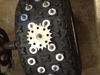

lil Doobie420 Posted January 19, 2015 Report Share Posted January 19, 2015 I do and they work great on hard packed dirt I used 5/16x1.25 bolts with washers and nylon lock nuts. They doo work and the hard ware was only 30$. Quote Link to comment Share on other sites More sharing options...

Deadbeat Posted January 20, 2015 Report Share Posted January 20, 2015 I do and they work great on hard packed dirt I used 5/16x1.25 bolts with washers and nylon lock nuts. They doo work and the hard ware was only 30$. might want to mention the washers both sides too homie lol Quote Link to comment Share on other sites More sharing options...
lil Doobie420 Posted January 20, 2015 Report Share Posted January 20, 2015 This:-) Quote Link to comment Share on other sites More sharing options...

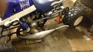

Tommygunn Posted January 21, 2015 Author Report Share Posted January 21, 2015 Running at Busco Beach in North Carolina. Ground is hard packed dirt. We mainly just go up there and drag race for fun. I have a 2ed set of tires id like to set up before this weekend. After doing a bunch of searching all over the internet, I think I'm going to run 3/8x1.5 bolts with washers. How many would you say I should run in each tire? Also is grade 8 really needed or can I get away with grade 5? I'm pretty stocked up on grade 5 bolts but I can get grade 8 at the hardware store for $45 Quote Link to comment Share on other sites More sharing options...

Tommygunn Posted January 22, 2015 Author Report Share Posted January 22, 2015 I was told to run about 30 in each tire. I'm about to start on it. I'll post pics when I finish Quote Link to comment Share on other sites More sharing options...
