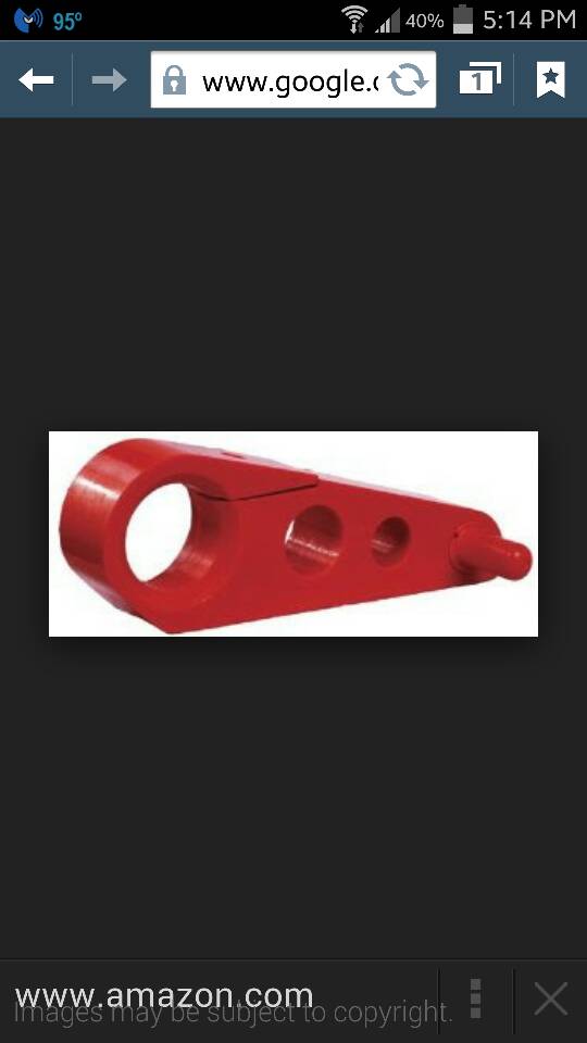

muggzy Posted August 17, 2014 Author Report Share Posted August 17, 2014 Can anyone tell me what brand that is? The only thing I'm finding on Amazon is mod quad and it doesn't have the "split" Sent from my KFOT using Tapatalk Quote Link to comment Share on other sites More sharing options...
Atomic Monkey Posted August 17, 2014 Report Share Posted August 17, 2014 Moose, but that still has the step for the dust cap. Might just have to get the right size holesaw to customize one. Quote Link to comment Share on other sites More sharing options...

muggzy Posted August 18, 2014 Author Report Share Posted August 18, 2014 (edited) Moose, but that still has the step for the dust cap. Might just have to get the right size holesaw to customize one. Yeah, I need the step. The pics are from the arm I have. The arms I'm looking at don't have that ring to the right of the dust cap. I really wish there there were people in my area that ride banshees so I can compare notes. Guess that's the great thing about forums I use the Cascade Innovations Chain Slider. Works great. http://www.cascadeinnovations.net/store/store_view.cfm?store_area_id=3&STORE_DEPT_ID=10 Nice! This'll be perfect for the front and rear chain slides. Was hoping for a front slider that could be removed without dropping the arm (just thinking down the road) but if this lasts anything like the TMD slide, it wont matter. Btw, the TMD slide I have now doesn't have a step. Unless I fab something up, I don't think it'll work. Edited August 18, 2014 by muggzy Quote Link to comment Share on other sites More sharing options...
