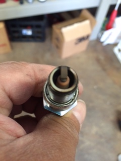

Joeladm Posted May 19, 2014 Report Share Posted May 19, 2014 This is the left side Quote Link to comment Share on other sites More sharing options...

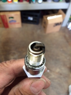

Joeladm Posted May 19, 2014 Author Report Share Posted May 19, 2014 Right Side Quote Link to comment Share on other sites More sharing options...
Joeladm Posted May 19, 2014 Author Report Share Posted May 19, 2014 So I was wondering what you guys think? I have a slight bog about 1/2 throttle. Quote Link to comment Share on other sites More sharing options...
Burke Posted May 19, 2014 Report Share Posted May 19, 2014 raise your needle 1 groove Quote Link to comment Share on other sites More sharing options...
Joeladm Posted May 19, 2014 Author Report Share Posted May 19, 2014 I have T-6's and have Toomey needles and 280 mains. So drop the clip to the next notch down? Toomey needles have 6 slots and I'm at the 4th one down already. Quote Link to comment Share on other sites More sharing options...
03DMshee Posted May 20, 2014 Report Share Posted May 20, 2014 I would suggest you do a plug chop and check the REAL color where its most important...looking at the top only shows you so much Quote Link to comment Share on other sites More sharing options...
Joeladm Posted May 21, 2014 Author Report Share Posted May 21, 2014 Ok, will try to do over the weekend. Quote Link to comment Share on other sites More sharing options...
oldskool Posted May 21, 2014 Report Share Posted May 21, 2014 I have T-6's and have Toomey needles and 280 mains. So drop the clip to the next notch down? Toomey neOhedles have 6 slots and I'm at the 4th one down already. No, you want the needle to drop down into jet, so you would move clip up. Quote Link to comment Share on other sites More sharing options...
Joeladm Posted May 21, 2014 Author Report Share Posted May 21, 2014 So am I trying to lean or make it richer Quote Link to comment Share on other sites More sharing options...
ginger Posted May 21, 2014 Report Share Posted May 21, 2014 lean it Quote Link to comment Share on other sites More sharing options...
Joeladm Posted May 21, 2014 Author Report Share Posted May 21, 2014 Ok, that's what I thought. Quote Link to comment Share on other sites More sharing options...
